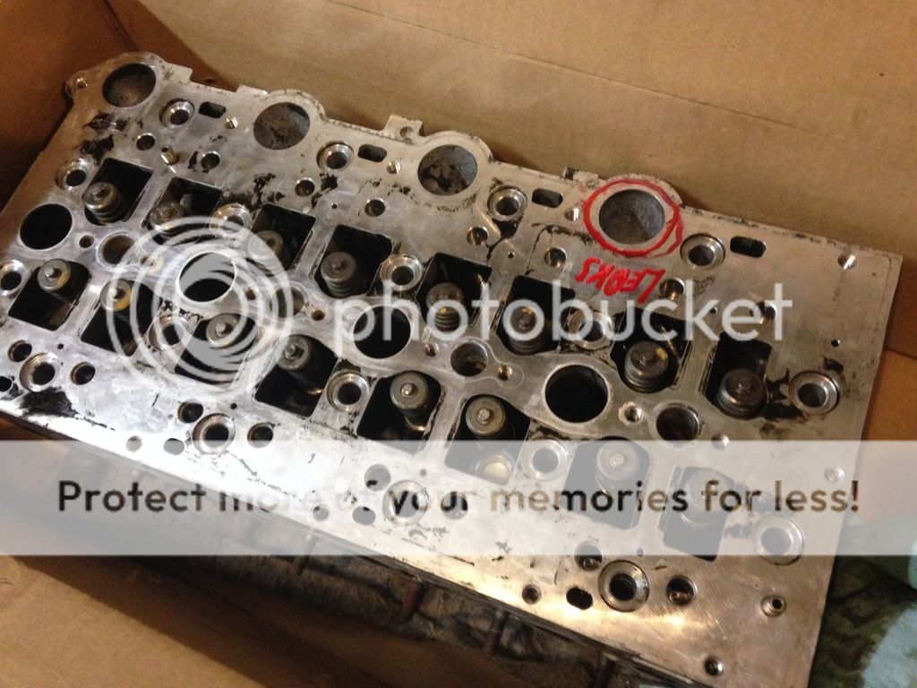

fool4wheelin wrote:
Pressure test results came back, leaky head. Somewhere between one of the intake feeds and the valve seat. Not looking forward to buying a new/reman head but might be a blessing in disguise.
I got a used replacement head from VMspecialists in England. Under $600 shipped.

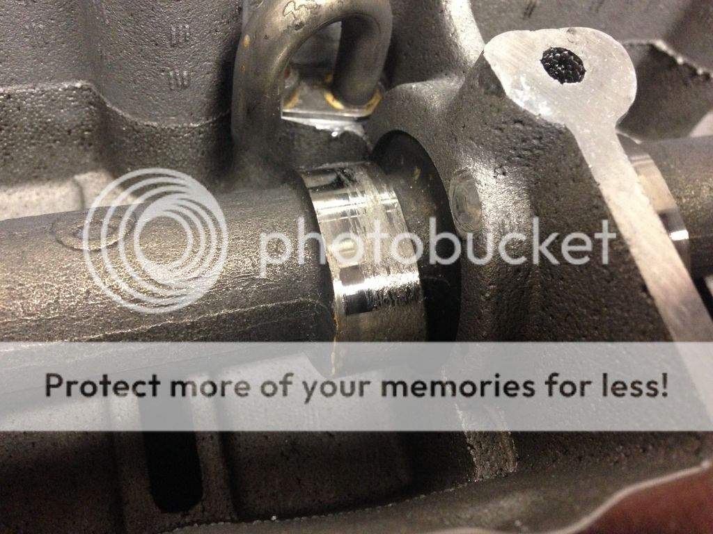

Thanks, this will help. What difference does it make, are they coded to the ECU or something?
Here are a some better pics of that bad cam lobe.

The code has to do with fine tuning and balancing somehow, but the CRD seems to run fine either way, matched or not. I'm not sure how much difference it actually makes.
That cam looks terrible. What did they write on the head?
LEAKS (If you rotate your screen 180° you should be able to make it out!)

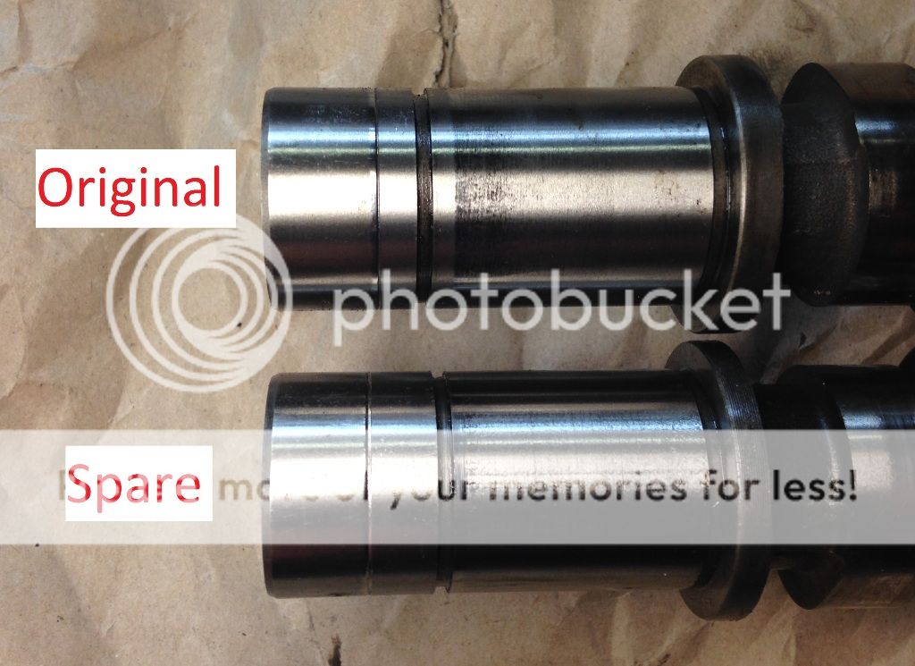

I was able to get ahold of a good used exhaust cam, but the snap ring groove is different than my original, appears that's its meant to be used without the backup washer behind the snap ring. Is this OK?? Doesn't seem like a good idea with that large oil drain groove on the face of the retaining surface.

 Post subject: Re: Pulled the Head.....Now What?
PostPosted: Mon Feb 20, 2017 11:18 am
Posts: 2663
Location: Boise, Idaho
Yeah, that's tricked a few of us. No washer indeed, but make sure the endplay isn't excessive

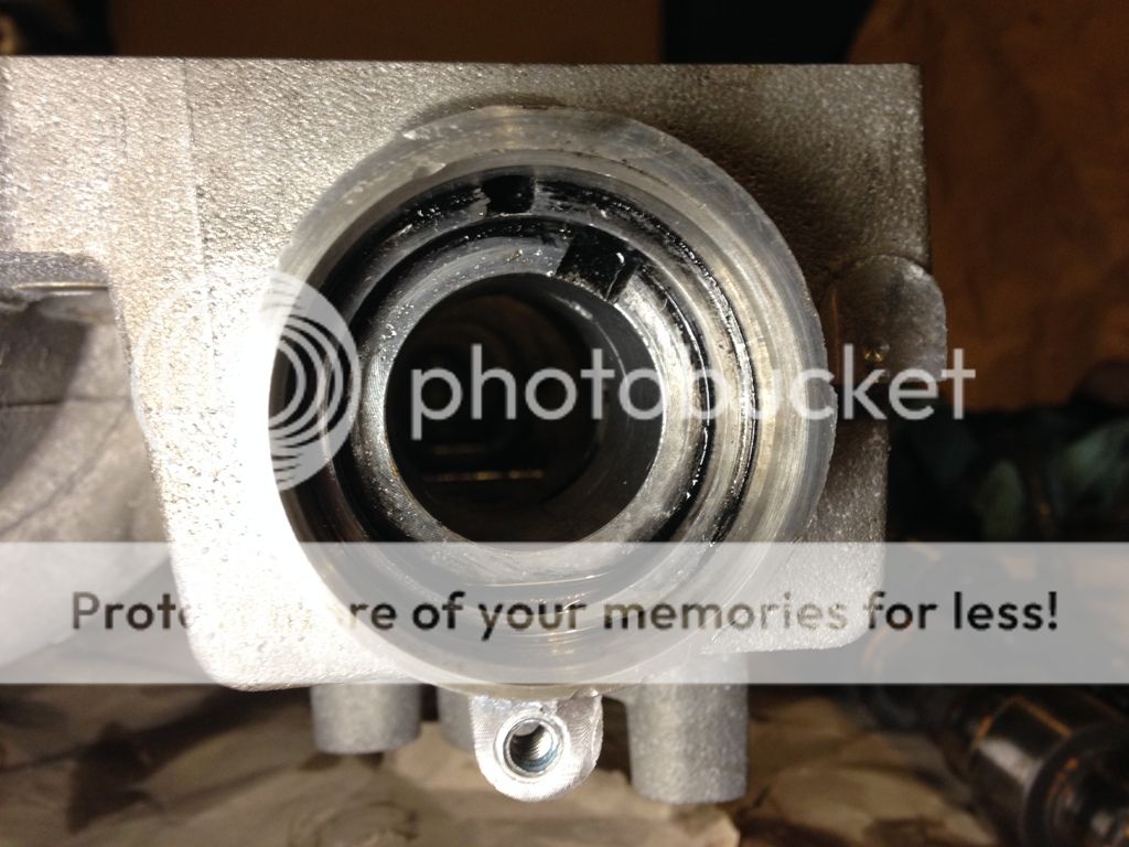

Was having a good day putting things back together till I stripped out the helicoil for the timing belt tensioner in the timing belt housing. Not sure how I did it, had the torque wrench set to 22 ft-lbs, must have buggered the threads or something getting the timing belt on. What options do I have? I saw one post where someone installed a stud into what was left of the helicoil. I was able to unscrew the rest of the helicoil from the housing, can I drill it out larger and use a bigger one? I also see there are a couple of used housings on ebay, could go that route too...
PostPosted: Mon Feb 27, 2017 12:12 am
Joined: Wed Jun 06, 2012 11:20 pm
Posts: 118
Location: Fargo, ND
Think I found my solution: https://www.amazon.com/dp/B002KWHWL6/ref=biss_dp_t_asn
PostPosted: Mon Feb 27, 2017 7:11 am
Posts: 4962
Happened to me too.
Fixed it with a standard heli coil and cut the head off a bolt to make a stud.
PostPosted: Mon Feb 27, 2017 9:12 pm
Posts: 7390
[quote="flash7210"]Happened to me too.
X2, thats a very good fix.... :!:
Heli coils tend to be more permanent than threaded inserts in my experience... :wink:

PostPosted: Wed Mar 01, 2017 7:58 pm
Posts: 118
Location: Fargo, ND
Too late, already drilled it out. I'm pretty impressed with the insert so far, screwed in easy and after it set up seems to be bonded pretty well.
