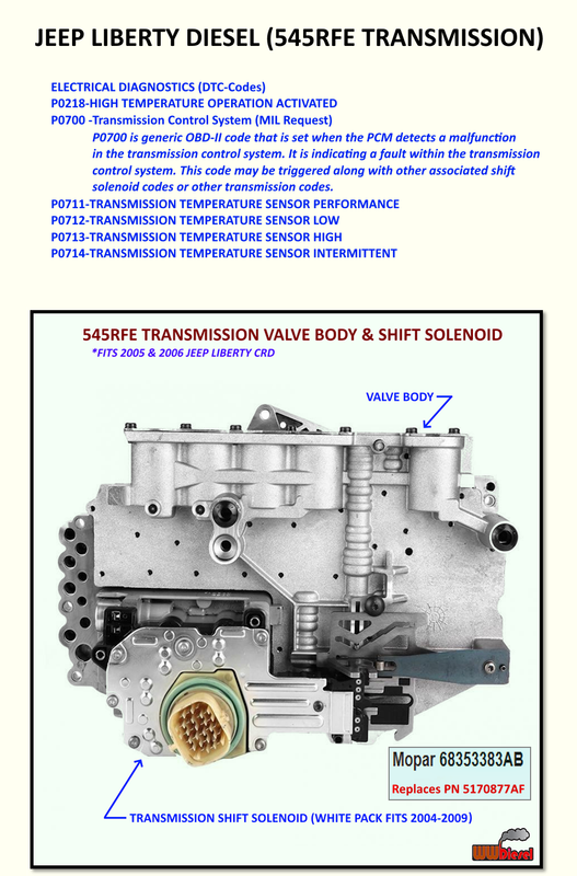

P0700 -- Transmission Control System (MIL Request)
P0700 is generic OBD-II code that is set when the PCM detects a malfunction in the transmission control system. It is indicating a fault within the transmission control system. This code may be triggered along with other associated shift solenoid codes or other transmission codes.
It will require a very high end scanner to sort out the root cause of the fault.
It may be more cost efficient to take your vehicle to a good transmission shop and have them read the codes for the transmission.
Most times, this code it triggered when there is a problem with the transmission electrical solenoid pack inside the transmission or its connection/wires, etc...
It is replaceable by simply dropping the transmission pan. Just be sure and use the correct solenoid pack color for your year model truck.

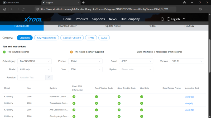

What would your suggestion on brand be, that has the capability of diagnosing the transmission ?
And what are your thoughts on the Xtool in the link, it describes things that seem like it can do
these things, as it says it has bi-directional capabilities?
Here's a review on the Xtool;
https://www.youtube.com/watch?v=T7DHPOIFZIc

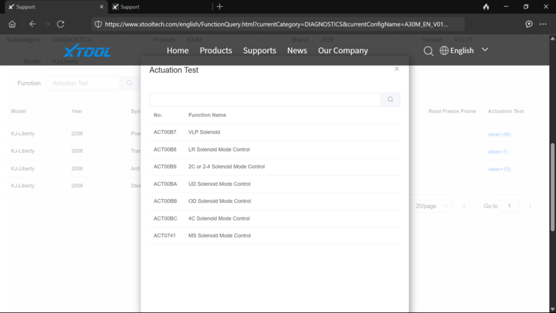

These pics are what the website shows, so is this too good to be true?

The problem is the CAN Bus network on the Jeep CRD is limited as to what you can talk to and retrieve. It is not as modern and robust as later model vehicles.
Every scanner is different in its capabilities, the only way to know for sure is connect one and see what it's capabilities entail. Being able to talk to the TCM for the transmission requires very expensive specialized equipment that only a shop that specializes in transmission diagnostics can perform.
If you can find a low budget scanner that will talk to the TCM in detail, please let us all know as that would be good information to know indeed.
