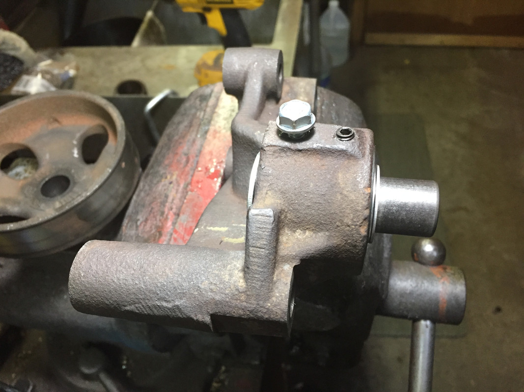

 Post subject: Re: Engine fan hub bearing!
PostPosted: Thu Sep 12, 2019 10:29 pm
Posts: 7403
Jeep Liberty CRD Mechanical Fan Hub (Rebuilt)
Picture of finished product:
Rebuilt using precision top quality bearings from a Commercial Bearing Supply Company. They are quite expensive as bearings go.
There are plenty of cheaper bearings available on line but I don't trust them, most are made in China or elsewhere overseas and are of questionable quality.
PostPosted: Thu Sep 12, 2019 11:34 pm
Posts: 324
Location: Dubuque, IA
Looks great, do you plan on running it on your Jeep to prove out the durability of the new bearings?
Was not planning on it as mine is OK right now.
Hoping to get some other fine tester who actually needs to replace theirs. :D
