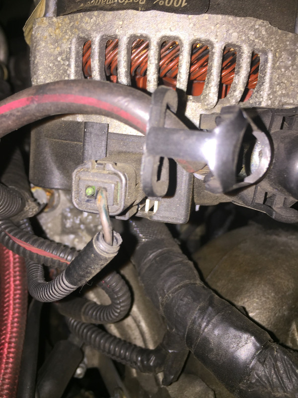

I may have found a problem. There is a single wire coming out of the loom below the alternator , it has a small female spade on the end. It will reach the alternator and there a few pins it will fit but I can see no evidence of a pin with any marks scratches that may indicate where it came from.
Any ideas

Post a picture of the wires.

How do you post an image here?
On Sir Sams noob guide there is an image showing the top view of the alt. I beleive my single wire goes to the socket on top of the alt.with 2pins, but which pin?

Thats the socket, its got 2 pins in it.
I have no plug that fits it but a single wire with a a small female push on connector that might to go there, the wire appears to be black with a blue green stripe

 Post subject: Re: hard to start
PostPosted: Mon Sep 16, 2019 12:53 pm
Posts: 7380
Looking at the FSM for both the 05 & 06 models that we have available for US models. Not sure your Aussie model is the same.
But strangely if you look up an alternator for an 05 and a 06, the same part number comes up for both years. :shock: :?
For the 05 model, Section 8W, page 20-3
it shows only one wire going to the No. 2 pin on the alternator that goes to the Front Control Module.
it lists it as a BR/DG wire. (Brown with a dark green stripe)
For the 06 model, Section 8W, page 20-2
it shows one wire going to the No. 1 pin on the alternator that goes to the Body Control Module.
it shows a second wire going to the No. 2 pin on the alternator that simply goes to earth ground.
it lists is as a BK wire, (Black)
The Factory service manuals are available online at:> http://www.colorado4wheel.com/manuals/Jeep/KJ/

thanks for the link. mine must be your 05 model late 06 here.
any idea which pin is which no marks on the socket I can find

I have an observation that confuses the issue even further for me. I had never noticed that there may be only one wire going to the two wire connector on 05 models so I went out to look at mine . I looked at two different 05 models and sure enough there is only one wire connected here and it is a dark wire with dark green stripe the non used side has a bright green wire that is cut off at the connector on both 05 CRDs. I then went and looked at an 06 CRD and it is exactly like the 05 models with only one wire connected and the bright green one cut off !!!
I would suggest that OP needs to look at a manual meant for his Aussie model or at least see if he can find out from another similarCRD in Australia. It might also help to trace where that wire goes as it seems like it should go to either FCM or BCM if its anything like ours. Even if traced and it does go to one of those still wouldn't know which pin to attach it to without some other info. I also do not think it would make any difference in the way it starts or runs but you never know.
Which pin did it go to on the ones you looked at?
There doesn't appear to be a manual for RHD. models. Mechanic that I spoke to told me that dealerships had nothing on vehicles before 2010 when a company shuffle apparently happened.
PostPosted: Mon Sep 16, 2019 11:16 pm
Posts: 7380
Went out and took a picture of mine, an 05 model.
The single wire definitely goes to the No. 2 connector just like the wiring diagram shows.
This would be the Right hand terminal as looking from the back or rear of the alternator as pictured.

I went out and looked at my 06 model just now and the wire attachment is exactly the same as my 05 CRD so connected to right pin as viewed from firewall side of alternator. I guess this means this is another FSM mistake found , either that or an assembly line manufacture mistake :shock:
PostPosted: Tue Sep 17, 2019 11:17 am
Posts: 7380
Strange to me that if you look up alternator part numbers, they are the same for both 05 & 06 CRD's.
Does not make sense that they would have different charging system wiring between the two models using the same alternator.
But not surprising on the FSM, it's not the first time an error has been discovered.
Maybe some later 06's do have a different connector and wiring? :?
PostPosted: Tue Sep 17, 2019 12:40 pm
Posts: 4962
The 05 and 06 CRD alternators and wiring are exactly the same.
That one small gauge wire connects to the voltage regulator.
All that one wire does is excite the field.
In most cases, that one wire can be disconnected and the alternator will continue to charge just fine. Inside the regulator is a capacitor and as long it has some charge in it will support the excitation.
(I know this because I repaired my alternator by replacing the regulator and disassembling the old regulator)
