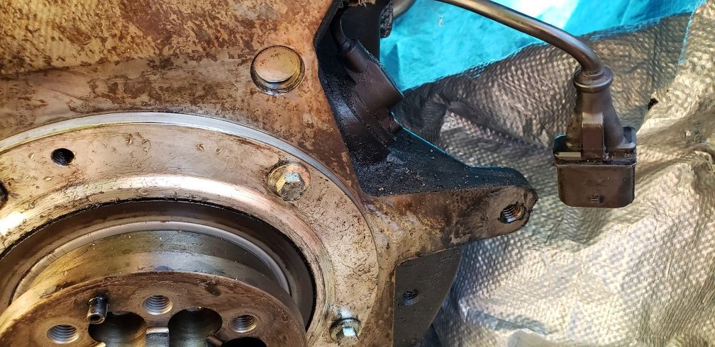

Today I removed the flex plate, drive hub, and the adapter plate. There was a real oil slick between the plate and the machined face of the block, somewhat reinforcing the concept that the leak is happening behind and above the plate. That said, I can't see any real source for that to happen save the head gasket. There are two plugs that look like freeze plugs back there, but IIRC at least one of them seals off an oil passage. There was some crud accumulation there, but hard to say whether it's leaking. Nothing specifically about it suggests leaking.
Despite being new and $50, I also removed the rear main seal. It looked great, nothing about it screamed failure. In fact, in other RMSs you can often see an oil accumulation along the bottom and that was not present. But, the RMS on this engine is real weird so I don't know what to expect.
I will post some pictures of this later on or tomorrow, once my phone has finished uploading them. Maybe someone will see something I didn't.
Now having done this work myself, I am at a loss to explain all the surface damage to the rear crank carrier. It's weird. Because there is that damage and the RMS is suspect, I want to remove that carrier and inspect. I'm curious if anyone has done that work... The FSM doesn't address removing the carrier in and of itself, only in the context of removing the crank shaft. To do that, it says to remove the head. I can't see any reason why I couldn't just remove the carrier now and the head later... but maybe someone knows otherwise?
OH! One thing... MAYBE. Before second guessing myself, I started to remove the carrier and I think one or maybe two of the bolts securing were VERY loose. I was using an impact wrench, but you can definitely tell when one bolt is less tight than another. I'm pretty sure.

Maybe two relevant ones:

I've decided to look for a replacement rear carrier... not sure how that's gonna go, but I'll try.

[quote="thesameguy]Still need to find that rear bearing carrier. I'm not sure where else to look. :([/quote]
There is a guy in Lithuania named Ed that has all sorts of VM & other engine stuff. I am not sure what name he trades under. His english is not the best but the translate programs work. I got to him via ebay a few years ago when I needed a #1 injector (with sensor) for a 425 VM diesel that was in an export XJ jeep. If you can track him down he would be your best chance next to VM.

 Post subject: Re: Well, here I go... pulling the motor.
PostPosted: Thu Oct 17, 2019 12:40 pm
Posts: 4962
About the ream main seal...
Pay carefull attention to how everything comes apart. Thurst washers have to go back in exactly the way they came out.
Hub adapter is the first part to be removed.
I suspect your rear carrier is still ok. But remove it so you can inspect the rear main bearing.
When installing the carrier, put some sealer on the inside lip to prevent leaks.
I have not done this job myself. Just reviewing whats been posted before.
My RMS has had a small leak since like forever.
Installing a Provent and switching to 15w-40 has noticably reduced the leak.
I also dont fill the oil all the way to the FULL mark. Just about halfway between FULL and ADD.
