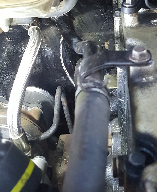

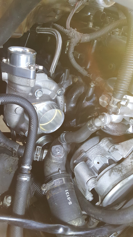

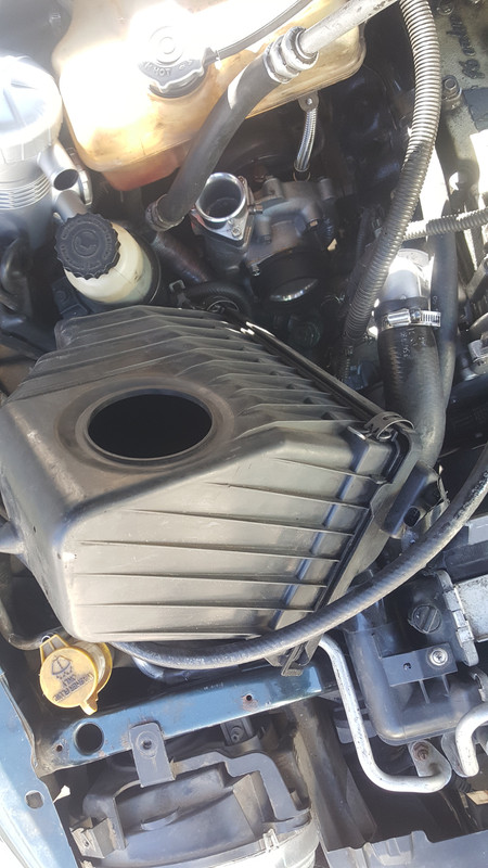

Pics with hoses installed. I opted to cut-apart the two metal stock heater-core supply/return tubes and only use the one that bolts to the top of the valve-cover for the HC supply before it loops out and through the turbo:
https://i.postimg.cc/fySSYQCn/20200205-170411.jpg
https://i.postimg.cc/yNwDBbBL/20200205-170430.jpg
https://i.postimg.cc/6pFWG4S3/20200205-180245.jpg

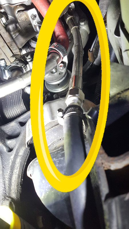

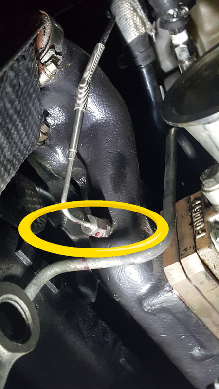

And shots from down-under:.
Circled:
- Turbo coolant-out line, straight-down then looping behind motor mount and straight-up to water pump housing.
- Installed custom dual-tap oil drain tube & retainer tab.
- Drain tube connected to oil-outs of both turbo (black hose) and provent (red hose, check-valved).
- Adapter plates from [ceramic-coated] stock exh man to Garrett GT2560R.
- EGT sensor into exh man:
https://i.postimg.cc/vmdRsrkW/20200205-182710.jpg
https://i.postimg.cc/wjM5jn8z/20200205-181734.jpg
https://i.postimg.cc/R0cWSTF9/20200205-181342.jpg
https://i.postimg.cc/7PSKvvDQ/20200205-181937.jpg
https://i.postimg.cc/85zN2dfZ/20200205-180852.jpg
Attempting launch shortly... :shock: :frankie:
UPDATE: TURBO IS NOT(!!!) LEAKING!
Factory-recommended procedure for checking turbo blow-by:
https://i.postimg.cc/sf7cZgPK/20200206-103452.jpg
https://i.postimg.cc/CLvfR32m/20200206-101728.jpg
The flipped airbox's output is taped directly onto the CAC input, leaving all in/outs @ turbo easily observable for oil blow-by (leakage). How the crew of Apollo 13 made it home without gorilla tape is a complete friggin' mystery... :ROTFL:
'15: bought '05 w/138k.

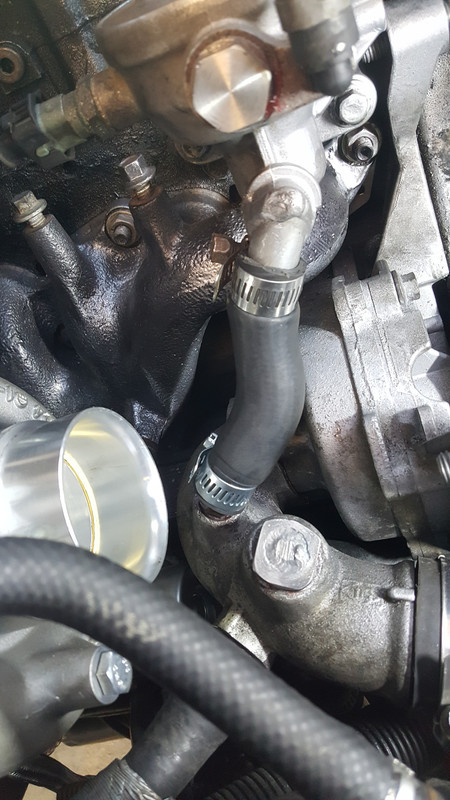

Pics of recently-installed pre-turbo cooler/routing. All 1/2" hose Thermo-Cooler-Turbo (including brass elbows at cooler), then 1/2-5/8" adapter post-turbo and direct into W.Pump intake cowl:
Brass elbow @ thermo-out to cooler:
Circled: brass elbow Turbo-in from cooler, Heater core out adapter 5/8-3/4" then stock heat-shield split to sheath 3/4" line to "T", combining coolant tank's 3/4" gassing down-hose (arrow) before entering pump cowling:

I guess now I can conscionably remove the pooch from the engine compartment.
If >20mph vehicle-speed airflow* trumps fan-generated airflow, then if temps are spiking at highway speeds are fan-specs even a consideration?
I'm schooled to the logic. However, mine idles cool and actually the slower I drive up long grades (say, 50 vs >65) the slower the temp begins to spike.
Today I thought about the H2O pump. Installed new @ major work 4 yrs/20k ago; hard to fathom that it may already be failing, but no stones unturned.
I'm at a crossroads. I need to order a replacement turbo ASAP, and controlling these temps is fundamental to whether I revert to a non water-cooled journal-bearing unit or buy another Garrett GT2560R. If I was certain that the Garrett was causing these coolant-temp spikes then I'd be extremely tempted to revert to an oil-only turbo and cease trying to beergineer how to successfully stabilize coolant temps just for the luxury of running an h2o-cooled, ball-bearing turb.
Related, my recollection is that before the turb upgrade I did the mech-fan elim for a used Ford TBird electro-fan. I'm pretty sure that fan kept the temps stable, but am going senile so maybe no. Anyway, the 16" derale puller + 2 9" pushers combined blow at least 50% more air than the Tbird fan (dog-ear calibrated). Does that necessarily mean that plumbing-in the h20-cooled garrett caused the coolant spikes? Not definitively, but very suspicious.
I have also substantially modified the non radiator-related coolant path. The addition of the pre-turbo cooler definitely helped, but not nearly enough to trust for hot-weather climbing/towing. During my many mods I've kept nearly all of the stock parts, but in order to restore the coolant path to bone-stock I'd have to re-design/route my snorkel setup = nope. If I do opt for a non h2o-cooled replacement turbo but temps don't stabilize, it's back to the bar, pooch and protractor.
If I was confident that the garrett was NOT responsible for the coolant-temp instability I would def replace with same turbo. About $200 more than journal options but worth it for hp-bump and h2o cooling.
Your knowledge, thoughts and time are greatly appreciated!
*what if you have notable tailwinds? Presumably, there goes your headwind passive-cooling, proportionately...
