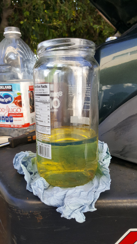

HOWEVER... I then went to check fuel-flow volume at the output of the filter-head. This pic is the total amount of fuel the Kennedy pumped into a 20oz jar in 2 30-second bursts. 7oz of fuel in 1 minute = NOT good:

My prior rejection of a fuel supply diagnosis is still buoyant. It makes no sense to me that a fuel volume/pressure issue would permit full power cold but then cut-out after reaching op-temp. That strictly points to the ECU deciding "uh-uh" @ >185f-ish; an electronic metering malfunction, not supply issue.
I'll try to tshoot the tank/pump issue tomorrow. Once I've restored flow volume/pressure, I'm still expecting the same symptom of a cold-hot power discrepancy.

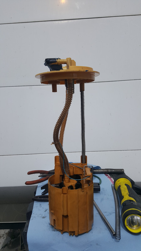

SOLVED.
Carter is in w/solid flow to the filter head (unlike Kennedy, Self-Priming!). Road-tested @ Idle/WOT/Highway up to 4k rpm sprints; no lag or sputtering, full-power available w/no intermittency. Only codes good ol' 403/1140 egr-related DTC's.
I suppose the take-away (yet again) is "if you hear galloping think 'horses' before 'zebras'": Fuel Delivery before exotic ECU issues. That said, I still don't entirely grasp why I consistently had full power/boost when cold vs op-temp.

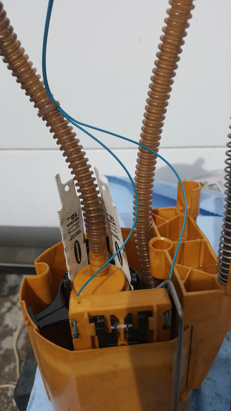

To drop the tank I rigged straps under the tank routed from the axle over the hitch assembly. Lowering was a breeze; raising, however, was a predictable pita:
Unfortunately, the tank was 3/4 full during the pump R&R. That made emptying the tank for a steam-clean impractical (bummer). I did remove the in-tank pickup assembly to inspect for filth or damage. In order to lift the "filter cap" out of its' weird tri-clip I wedged 3 sawzall blades under the clips, permitting it to pop out:
Surprisingly, there was essentially no muck contaminating the pickup assembly, but one of the two spring-loaded guide bars had wriggled loose, viewable laying on rag next to unit (easily tapped back into place on bench):
Redesigned hose routing so tank wont have to be dropped to R&R pump. The "S" assembly was hard-mounted into the kennedy before, now it's accessibly hose-barbed:

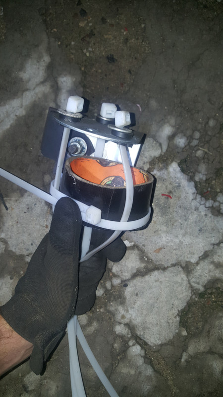

A few criticisms of the Carter:
- The supplied mounting nuts/bolts are unusably cheezy.
- NOISY! Holy crap, this thing howls. Maybe their better model pumps are quieter. I invested an extra 4 hours implementing home-made anti-vibration measures, reducing maybe 40% of the in-cab whir. Closed-cell rubber placed between all mounting plates/hardware, and used beefy zipties to dangle the pump from the supplied mounting plate w/rubber grommets. Pic attempts to illustrate "suspension" mounting concept; just pretend the roll of tape is a (noisy) fuel pump:
I doubt I'm the first person to use zipties as "flexible retainers" by chopping-off an end to use as a "nut" while using a full-length tie as a bolt. Notably effective method for solidly securing fans/coolers etc to radiators.

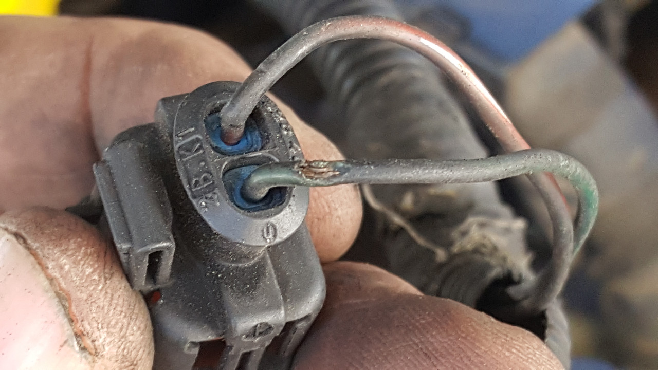

So, the Carter went quiet. Which would have been very welcome if it didn't mean it wasn't pumping fuel. The jeep then started stalling on >20% accel and/or climbing. I quickly realized it could coast in neutral without stopping and then started back up after gliding for 7 seconds.
Result: a stressful but successful 4-hour trip home across Baja @ 40mph (and >32mpg!).
Upon inspection, the Carter's crappy oem slide-on +/- connectors had popped-off the + terminal on the pump. I'm going to solvent-off the electro-salsa doused onto the connectors and then use a conductive epoxy to permanently glue the rat-bastard oem connectors onto the pump terminals.
TIP: The Carters include a comic rubber cup intended to slide over the bottom of the pump housing to retain/protect the +/- connectors at their terms. Drill a hole through the bottom of the rubber cup to allow drainage should you ford elevated water.
