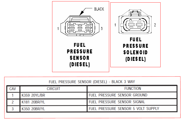

What I would do.
Using your digital volt meter.
Starting at each sensor one at a time.
Most sensors will have either two or three wires going to them. One is 5 volt power supply, one is ground (3 wire), and second/third is sensor signal feed to/from ECM.
With ign. switch in the run position, (all fuses good)
Unplug each sensor one at a time and using voltmeter, check for the 5v power supply at each connector.
One of the wires should read 5v or slightly under.
If you find a sensor that does not have the 5v power supply, you have possibly have found your shorted wire, trace it back.
You can check the FSM wiring diagrams to view what each sensor should have under the "Connector Pinouts".
Report back, good luck,

Flash, where is the rail pressure sensor and the rail pressure solenoid located?
1. Rail pressure sensor is 5v - Where is this sensor located?
on side of fuel rail
2. Rail pressure solenoid is 12v - Where is this solenoid located?
at end of fuel rail
3. Fuel quantity solenoid is 12v
1. in the middle of the fuel rail, has three wires
2. at the back of the fuel rail, next to the firewall, has two wires
3. on top of the CP3, has two wires
Note:
You can unplug the fuel quantity solenoid and the engine will start up and run.
In this way, all fuel is directed up to the rail and all fuel pressure modulation is controlled by the rail pressure solenoid.
If you unplug the rail pressure solenoid, the engine will not run at all. No pressure will build in the rail. All fuel will dump out through the return line from the rail.
