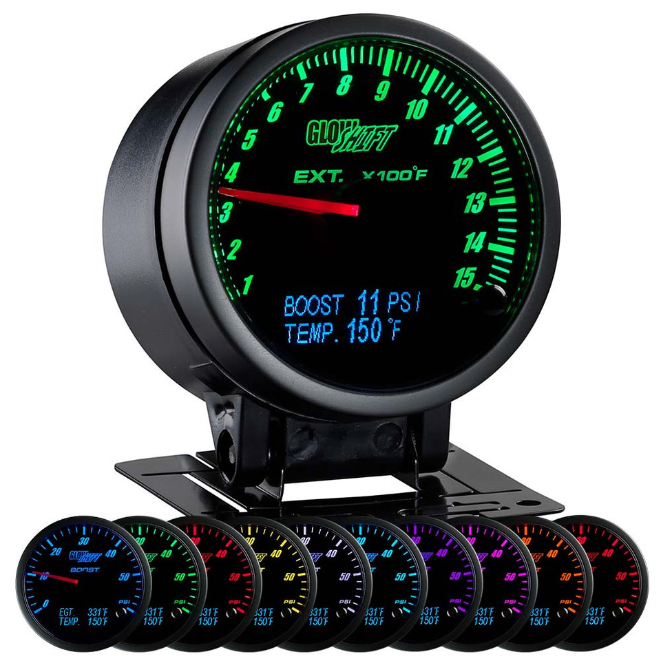

Does anyone know if there is an electronic "gauge" that can monitor EGT's and boost? Something like the Edge Insight CS2?
I'd go with regular gauges, but there isn't much space to mount them anywhere useful.
This is one, there are others. :wink:
GlowShift’s 3IN1 DIESEL COMBO GAUGES:
EGT w/ Digital Boost & Temp Gauge
https://www.glowshiftdirect.com/3in1-di ... bo-gauges/
