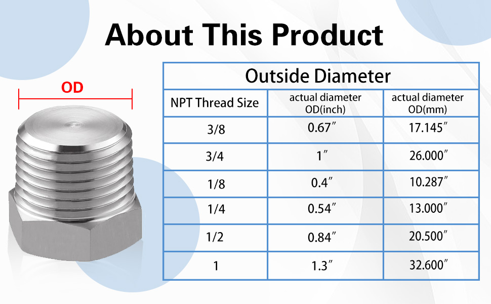

Standard Pipe Thread Tap (NPT Tap)
Threads are tapered to ensure a tight fit.
Standard Pipe Plug w/tapered threads:
