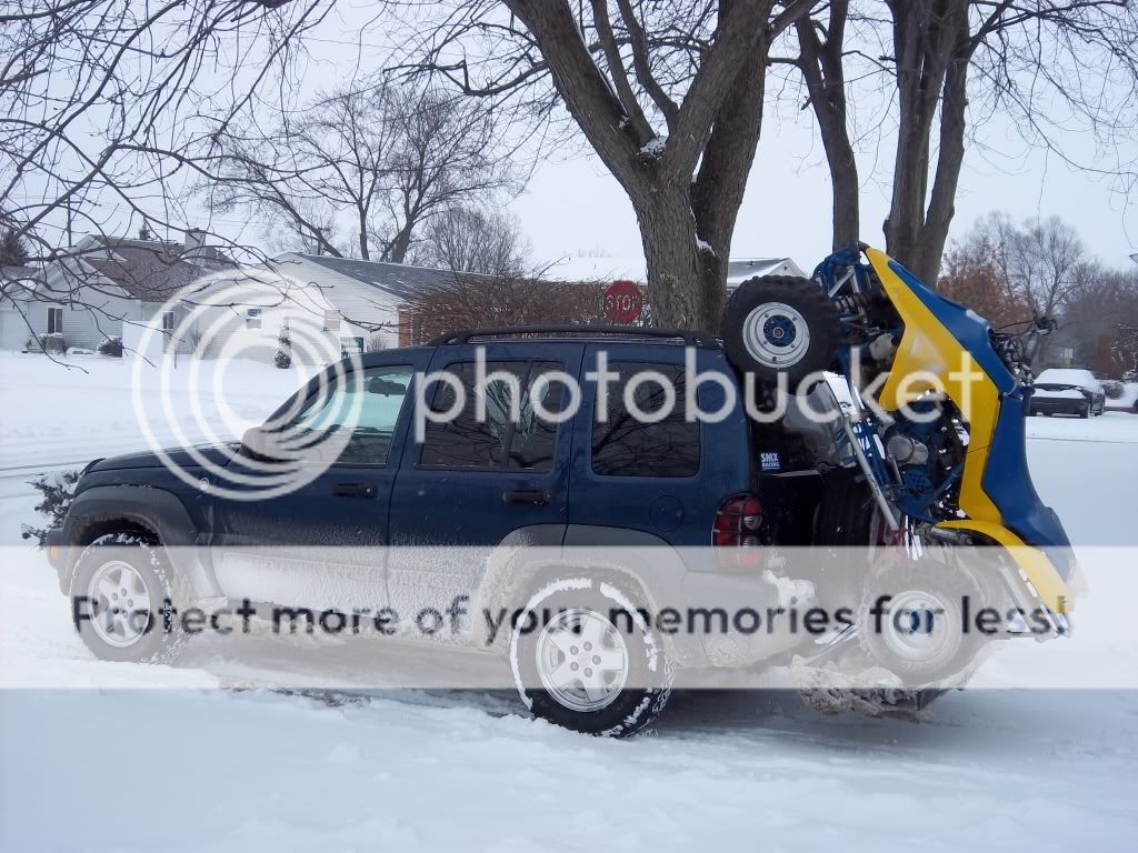

Took the Jeep for a 3 hour drive to Indianapolis. I found this and brought it back. Its a 1987 Suzuki LT500R (Quadzilla), Fastest production Quad built
Mine 2010 6.7L Dodge Ram 3500, Crew Cab, Long bed, Dually, 4x4 no mod's yet but a few are planned
The Wifes 2005 CRD Liberty with Fumoto Valve, Scangauge II, 2.5" straight pipe, EHM, and EGR unplugged awaiting poss Water Meth and a 2" lift kit
 Post subject: Re: What did you do to your CRD today?
PostPosted: Mon Jan 02, 2012 7:23 pm
Posts: 3059
Location: Oxford, Connecticut
Way cool, was it dropped off at your tailgate..
