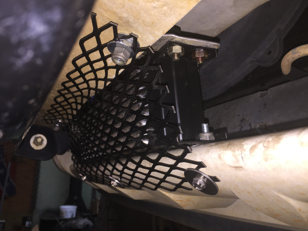

I then installed a Setrab 50-910-7612 under the bumper:
This cooler should be quite an improvement over factory - it's about the same surface area but about 3x the thickness. I have one tiny little detail to attend to this afternoon, but then it's ready to go.

That is a good location, that is where I mounted my 10 plate stacked oil cooler by Derale using AN fittings as well.
Once suggestion for your location, add some protective expanded metal over the cooler for protection from rocks, road debris, etc..
Cheap insurance! :wink:
