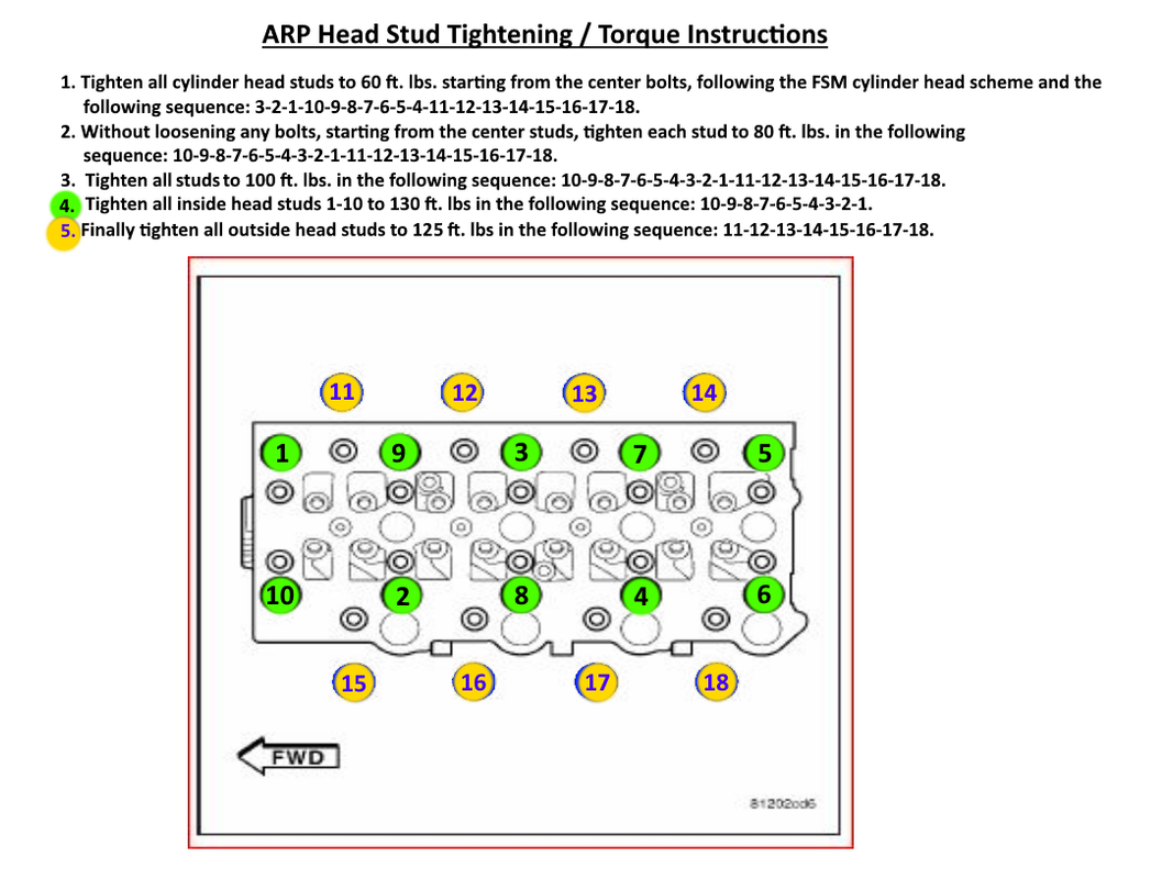

Now armed wit 20/20 hind sight and all the input since my first post this is my thoughts on my problem. The new style studs from ID have plenty of rolled threads on the bottom of the stud to bottom out in the block without thread binding I would buy them again. But being warned about the problem of studs 11-14 I would do the following.
step 1. install stud finger loose in block and measure height above the fire deck.
step 2. measure thickness of washer and nut.
Step 3. measure thickness of head through counter bore.
Add head gasket thickness + measurement of step 2 + 3 and subtract measurement of step 1
If the result is a positive number you are long by that amount and make adjustments accordingly.
I failed to measure the studs to begin with I only measured the amount of threads past the nut and subtracted that from the overall length and came up with 5.85" which I ground the excess off the bottom of the stud and deburred and polished it on a scotch brite wheel. I would guess the studs were 6" to begin with.
I should receive the final part needed to finish this project tomorrow keeping my fingers crossed.
I would not be comfortable mixing in the VW studs in locations 11-14 because the cross section of the stud is smaller and elastic charismatics would be different and may cause unwanted stress on the head.

Does anyone have a spare VW stud and one of the longer studs in question?
If so, could you measure the overall lengths of the two different studs and post them?
I believe it would be very helpful for this discussion.
What is known:
Height of cavity in web of valve cover above studs on locations 11-14 (~ 0.570) (may vary slightly from engine to engine)
Thickness measurement of a used compressed valve cover gasket (0.022)
So 0.570 + 0.022 = 0.592 which is the total available space or height of a stud extending beyond the top of the head to valve cover mating surface.
Using cts1950's measurement of 0.585 which would be just under the 0.592 limit and should fit?
6 inches would certainly be TOO long! :roll:

My 'normal' studs, measure 5.750 inch. Each end has 1 inch of threads.
Now, the other 'special' studs are also 5.750 long, but the end that screws into the block has thread that measure 1.35 inches long.
I'd say a big YES on the 6 inchers being too long for that position in the head. These are Whitbred studs.
When I'm ready to thread my studs in, I'll have the nut and washer already spun down to 1- 1-1/2 threads showing.. When the stud either bottoms out lightly, or the washer is making firm contact..(whichever comes first).
Should be ready for the torqueing sequence. I fully expect the 'normal' positions to have the stud bottom out before the nut/washer gets snug.. where I think it's a toss up on which will come first; stud bottoming out, or the nut getting tight on those 4 positions. I'm hoping for the nut to get snug!!
from 'my' math, I'd say a big YES on the 6 inchers being too long for those 4 positions.
Has anyone paid attention to how much the nut approximately turns, to make spec on the torque? (after all have been lightly snugged)? 3/4 turn? Full turn??

This is what I have on file.
If you search on LOSTJeeps, you can find a lot of information on installing the studs.
ARP Head Studs available at IDParts.com: https://www.idparts.com/arp-head-stud-kit-liberty-crd-idp4044-p-4044.html
ARP Head Studs Install Instructions
Per ARP regarding the proper way to torque the studs.
Blow out any debris that is in the holes.
1. Install a bone-dry stud into a bone-dry block and chase the threads with the stud up and down a few times to clean the threads.
2. Place a bone-dry washer on the bone-dry head.
3. Place a dab of lube on the upper part of the washer only, the bottom part of the washer must be bone dry.
4. Place a small dab of lube on the bottom of the nut.
5. Place a small dab of lube on the fine threads of the stud and screw the nut on till it reaches the top of the washer.
6. Use a small wrench to hand tighten the nut onto the head.
7. Using the proper torque wrench begin torquing the nuts in three separate torque sequences waiting 60 seconds between torques until the desired torque is reached.
Wait several minutes between each torque value.
Then wait 12 hrs. and recheck all torque values before final assembly.
