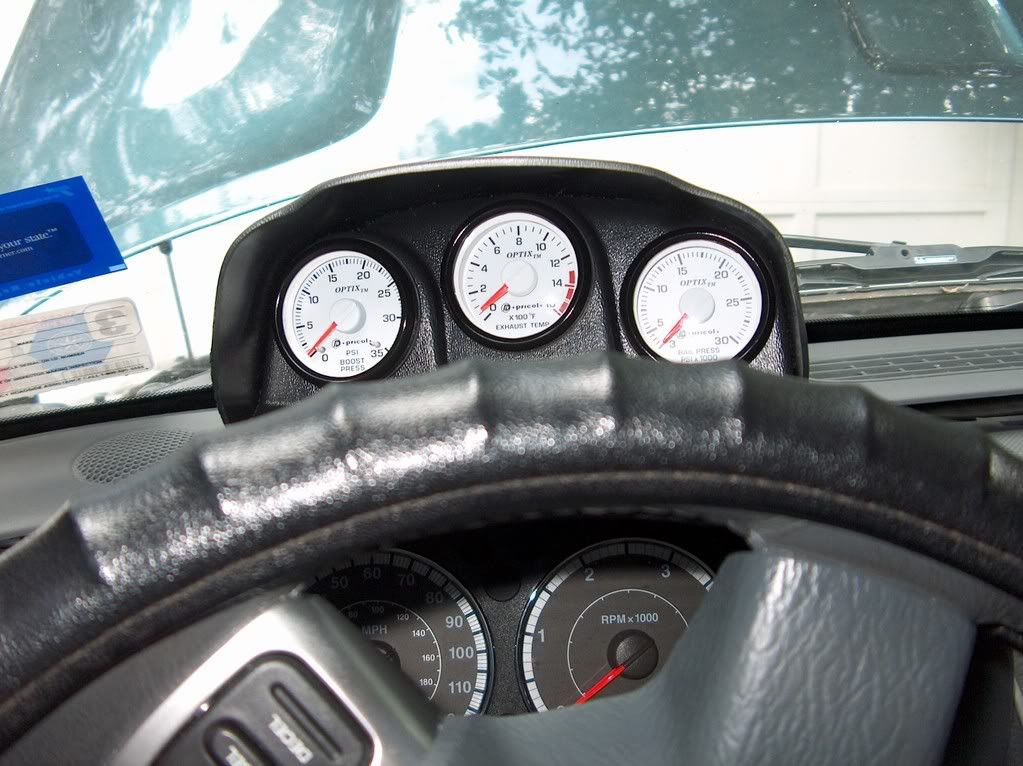

PostPosted: Thu Feb 19, 2009 1:03 am
ask and gmctd shall deliver :D
PostPosted: Thu Feb 19, 2009 1:06 am
Posts: 6302
Nice! I can't make out the third one tho... Something pressure. Fuel for the low side between the filter and the CP3?
I think I'm going toward a center-mounted cluster tho, above the AC vents. I have my GPS and XM radio there now, but those can be relocated to the sides. I don't think I want anything over the top of the existing dash hump. For a temp mount, I took the EGT gauge and just stuck it to the outboard side of the dash hump with some velcro.
I wonder if the space between the dash hump and the pillar could be filled in with a panel for 4 gauges...? Hmm. Something to think about.
PostPosted: Thu Feb 19, 2009 1:09 am
the one on the right is rail pressure
PostPosted: Thu Feb 19, 2009 1:37 am
Posts: 3092
Location: Texas
Correct - 0-30psi x 1000 - I don't like moving my vision much off center when polling for significant data whilst in the pilot's position, hence the high center-mount pod - quick flick of the ole eyebones and I got all the news that's worth noting, all the while avoiding that bimbo on the cellphone that can't make up her mind which lane goes best with her new outfit
