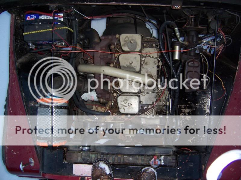

How about replacing the VM with a Cummins 4BT engine? Looks about the same size and it is readly available and not to expensive.
They do not make heavy enough front coils for a KJ to run that engine.Major modifications will be needed to shoehorn one of those bad boy's in a KJ.
I saw a CJ with a Cummins 4BT in it. Don't know what the owner had to do to put it in there but it looked good and apparently worked well.
Here is a link to a pic of a 4BT in a CJ engine compartment.
http://img67.photobucket.com/albums/v20 ... n_a_CJ.jpg
Leaf springs are a whole different story compared to coil springs.
How about the 4BTA? About 200 pounds lighter than the 4BT.
