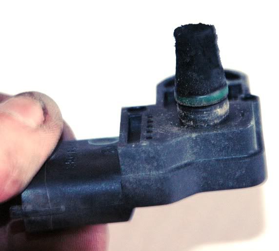

Changed oil, cleaned MAP, EHM.
Thanks Sir Sam and everyone that has added to the Newb thread!
BTW- The M-301 Mobil oil filter fit with no issues around my stock skidplate.
MAP was bad -

Cleaned the MAP sensor. 1st time ever cleaned at 78k miles and it looked pretty much the same as Roostre's. Thanks for the noob thread to let me know about this and it wasn't so bad that it doesn't scare me to keep checking and cleaning it regularly now.

Cleaned MAP sensor. Easier than I thought with the good information from you people on this site. Sensor was dry and sooty. Have 63k on the 06 crd and don't think it's ever been done. Used can of Gumout carb spray and worked real well. Blow dried with light air compressor before re-install. Disconnected batt. before I did it and took for a test drive when done, seems to have a little more pep than before. Love my CRD, been a real great little all around vehicle.
