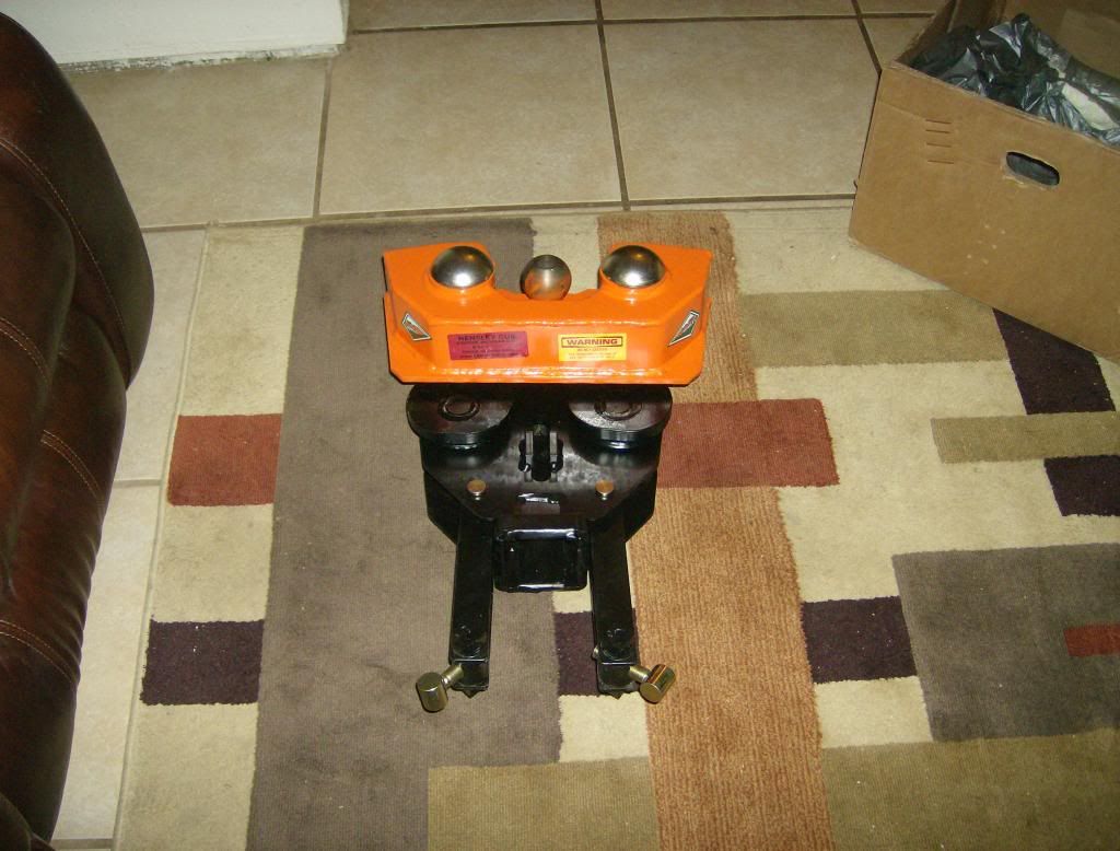

I'm spending a lot of money on my setup to make sure my family's is save. I'm putting the best hitch money can buy. Speed rated tires for the trailer the factory tires are rated at 65 max. Don't want to run my tire at the max speed. I'm not planning on running 75 all the time. But I am planning on holding four gear to a higher rpm down hills to hold speed up the next hill.
Our last trip to Destin Fl was 15 hours one way. Our next trip looks like about 12 hours one way to Red River NM. I would like a little better drive any suggestions would help. Thanks
Got the hitch waiting for some good weather to install. Thanks for your concern for me and my family.
