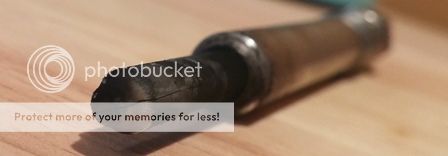

Late to the dance as usual, but here it is. I paid the $12 or so for the upper gasket. There is a lower gasket AND an O ring #0514 2806 AA. . O ring cost $2.70 USD. It's an order part, so it takes a few days. I ended up using the upper gasket (Squeeto made his own) and used red RTV on the three connections. O ring arrived after job was done.
FWIW, the fault code said #4 gp was bad. It had 'nodules' on the tip. #3 gp was covered with soot.
None of the plugs had been broken off.
PS Etecno plugs installed.
You really should best a GDE tune and that will reduce the soot on #3 gp'among a half dozen pluses
