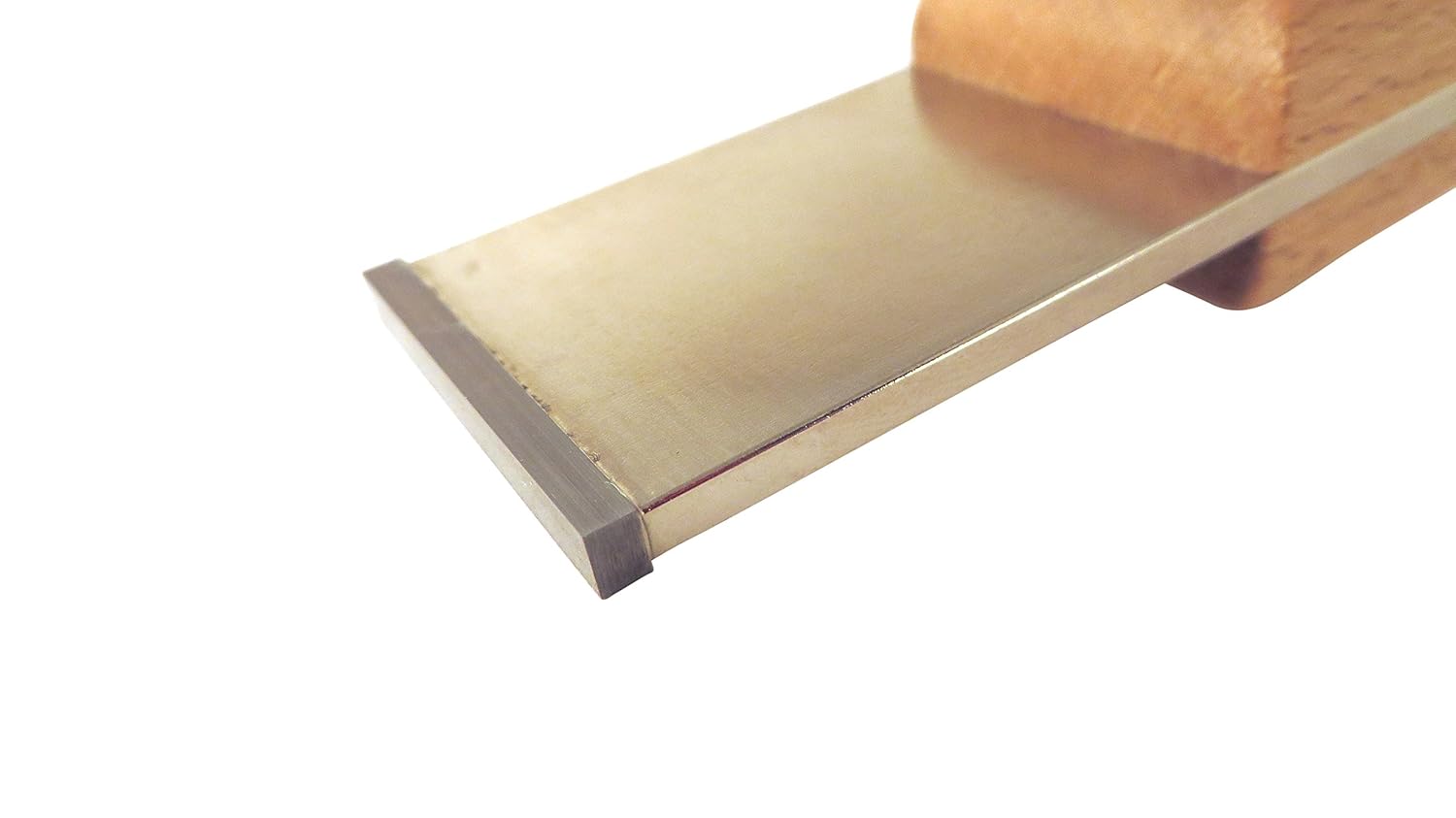

I used my SuperScraper(tm) to prep the block deck. I really love that scraper! It's a wood handled flat bladed scraper, with a carbide tip. It absolutely chops through rust and gasket material, right down to the base metal. Neat thing about it, even on aluminum surfaces, it's very forgiving.
Almost impossible to get wreckless with it. If it ever gets 'dull', just send it in to the company and they'll put a new edge on it. Even brand new, it doesn't feel 'sharp'. My machinist was bragging his has scraped over 300 engines, and still has the original edge. Just don't drop it. Carbide is not shock resistant at all.
I held the shop vac just ahead where I was scraping, and 99% of the debris got sucked up before it could fall into oblivion... or worse!

I've dealt with wood machining for a dozen or so years, so have some experience with carbide vs steel.
There are various grades of both, but generally carbide is brittle and lasts 2-3+ times as long as steel before needing sharpened, but will never take as fine (sharp) an edge as good steel.
Carbide is preferred for large long component runs for it's resistance to glue-line imprinting and long lasting edge, but shatters easily. For specialty items or small runs with exotic woods, knife steel is preferred to lower the possibility of wood grain tearing or splintering causing reject components.

The cutting carbide, a 'square' much like a keystock, is brazed to the tool. It doesn't feel 'sharp', it's weird to explain! All I know it's the most durable, safe way (me and the parts) to 'really get it done' I've found!

Got it.
