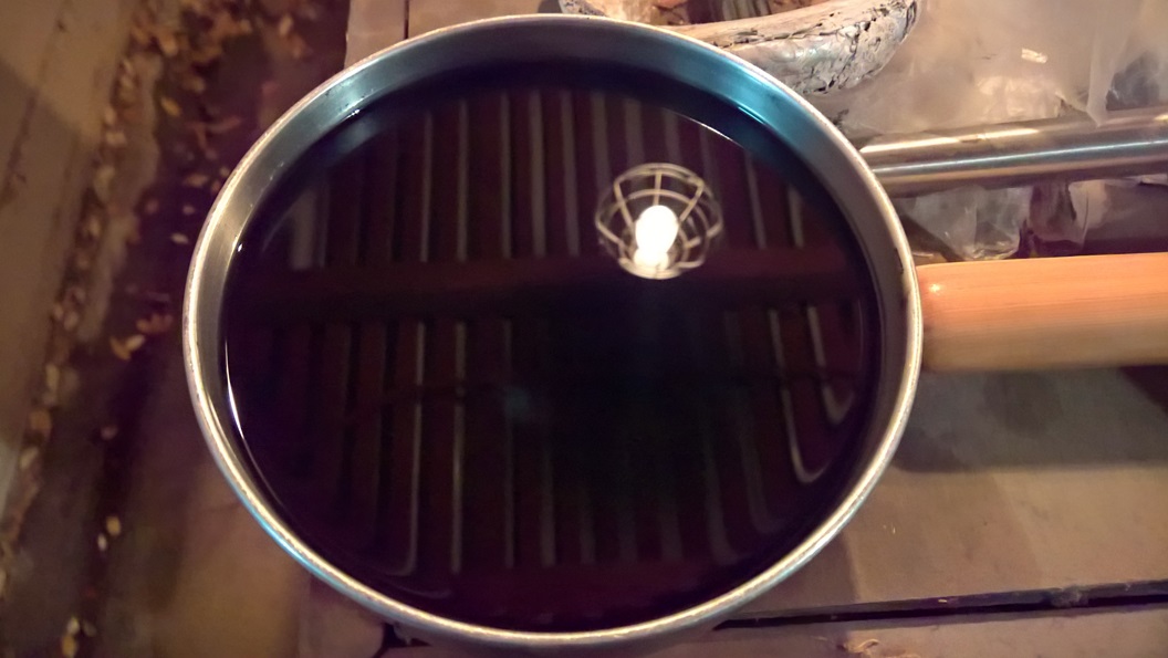

Got the replacement glow plugs in on Friday. During the operation, I found this:
Which, you know, is expected after 10 years and 180,000 miles.
I remembered I had about a quart of diesel in a jerry can from 2005 (derp) that was never going to go into a car, so I poured it into a bowl and dropped the elbow in and let it soak over the weekend.
:up:
Now that quart of diesel is totally wrecked!

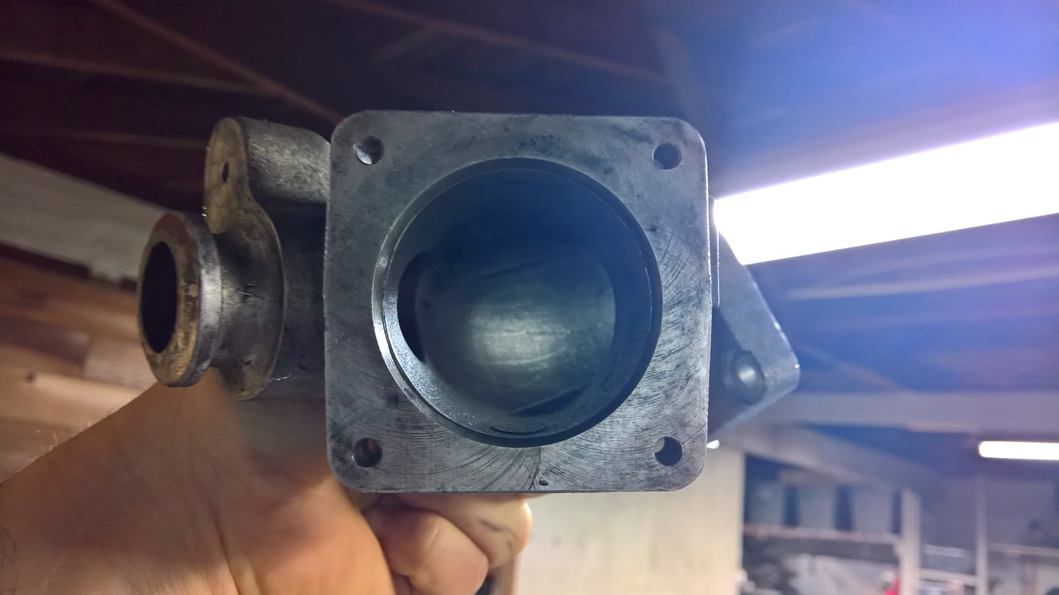

Hmmm... Also...
While the intake elbow was off I ran a cloth around the inlet to the intake manifold, obviously pretty nasty in there too.
I will go ahead with both a Provent and a GDE tune, but after all this work and then tires I'm going to be broke for a bit. I could swing either the Provent or the GDE pretty quickly, but I'd like to go ahead and get the programmer with the GDE just to make my life easier, which puts it out of reach. I may just wait a month or so until I can get both. I can't imagine another 1000 miles in stock shape is going to do more damage than it's already done over the last decade.

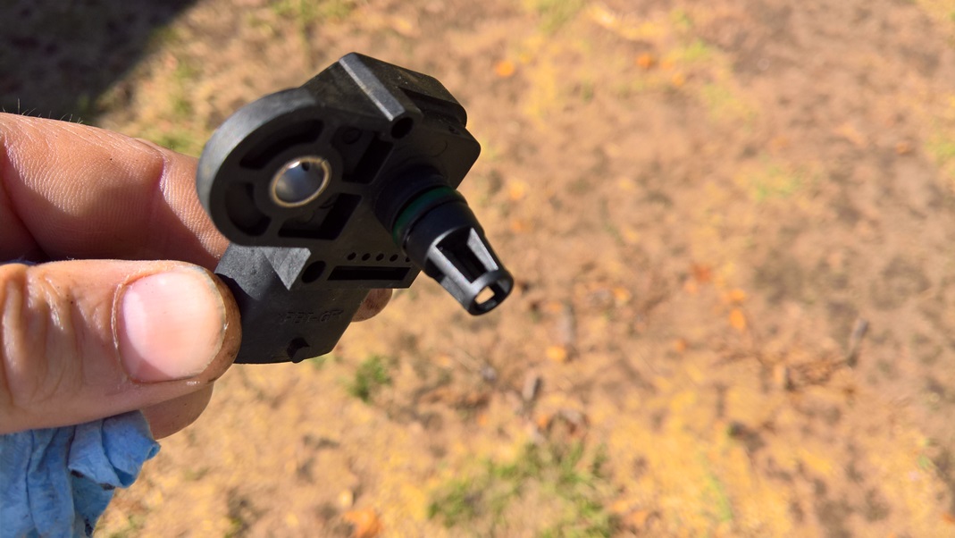

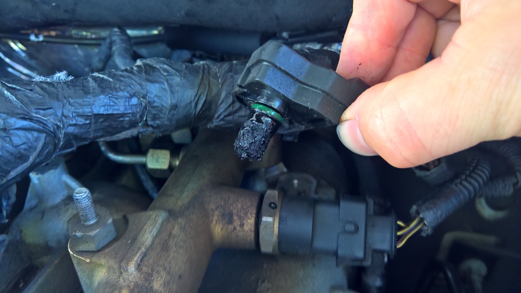

Heh.
Wasn't exactly sure how you clean a MAP sensor, so I used MAF cleaner. Figured if it's good on hot wires it should be fine on whatever MAP sensors are made of.

Ooh! You definitely need to blank off that EGR tube and / or install a Weeks elbow kit which eliminates the EGR, EGR cooler, and FCV... :shock:
If you cannot swing the Weeks kit right now, at least install an EGR blank on the feed tube to stop all that crap from coming into your intake...your motor will love you for it!!!! :wink:
EGR Blank dimensions:> http://www.lostjeeps.com/forum/phpBB3/viewtopic.php?f=5&t=76576&hilit

An EGR block off plate and free tune will not impact inspection at all, and I doubt very seriously any inspector would even notice an EGR valve, EGR cooler, and FCV are missing. :lol:
As to the ProVent, if plumbed carefully, it can look very OEM... :wink:
