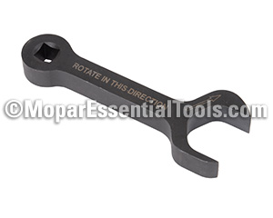

Hmm, I hadn't considered the fact that the crows foot adds a little leverage to the equation. After much searching I found a few side cut 30mm sockets specific for the task, but they were all in Europe, some were in large kits, and none of them had prices :furious:
I'm sure they would be too expensive to import anyhow. If we could find one inconus that might be reasonable, but carefully cutting one from a very deep 30mm might be worth a try. When I need one, I might give it a shot. I would be cutting it with a die grinder and dremel, so it would suck, and I'm not sure how successful I'd be?

http://dieselland.eu/DL-CR-TOOL-KIT-Too ... injectors/
I forgot the link

the torque sleeve is a smaller diameter than the body it would have to go past, so a socket won't work.
What I was planning to do was take a piece of 1/4" x 2" x 16" steel bar stock, Heating it and bending it around a piece of 4" pipe, so the ends are parallel, and trimming any parallel access off. then one end would have a 30mm socket cut into it, and the other would be drilled at the same center axis, and a broken 1/2" to 3/8 stepdown drive welded there, so wrench torque would equal actual torque. It wouldn't have to be anything super hard since the most torque it would need to hold is 59 ft lbs.
Now, with this tool, all I have to do is measure the distance from the center of the square drive to the center of the valve axis. and do a bit of math.
(for example)
Given, that a torque value in ft/lbs is lbs of force applied at 12" from the rotating axis, applied 90 degrees to movement, no matter the size of the torque wrench.
IF the distance from the center of the tool drive is (for example)2" you would add the 2" to the 12" that the wrench is designed for, and divide (12/14) as correction factor.
And the torque value needed is 44 ft lbs
Then you would multiply 44 x (12 / 14) = 37.7 ft lbs for the wrench setting. I would just round up to 38.
As much as I hated algebraic story problems 4 decades ago, they have been really freakin handy in life.

[quote="GordnadoCRD"]the torque sleeve is a smaller diameter than the body it would have to go past, so a socket won't work.
(for example)
IF the distance from the center of the tool drive is (fmy example)2" you would add the 2" to the 12" that the wrench is designed for, and divide (12/14) as correction factor.
As much as I hated algebraic story problems 4 decades ago, they have been really freakin handy in life.[/
quote]
I think that tool is slotted such to be wider in the center and 30mm at the end, and be specific to this application, but either way, a $6 crows foot (plus shipping) and your fine math is much better! I'd like to see if the local Bosch place can get it just for kicks.
Heck, what does the manual call for? I might have the tool in my factory set lol

I went to the biggest parts place in this area who usually carries pretty much any special tool, and this piece is current technology in GM LML series 6.6L Duramax diesel.
Even their gm catalog listed no special tool for it. There were 3 guys digging through catalogs for a half hour and every one came up empty.

No I checked with the local dealer and all he could do was order the same thing for a lot more. Stuff he had only went to 7/8", and costs way more. This tool will do the trick. If you look at the fuel rail pics, you will see there is a turned down section where it threads into. It's about 3/4" back, so when it's in position to be torqued you can actually get a true crow's foot wrench on. But a simple open ended wrench took it off with no stress or damage, so it should be fine to torque it.
I won't be back at my computer for days, but doesn't the manual specify a special tool?

No special tool mentioned, at least not in the 2005 service manual. They just instruct you to loosen/tighten the nut, but don't mention any particular type of tool.

Same with the 06 manual

I talked to "Hands On Tools" http://www.handsontools.com/
They could not find a tool listed either and they list most all Miller tools for Dodge, GM, and Ford. :shock:
They suggested to contact:
Mopar Essential Tools and Service Equipment
Hours of Operation: 7:00 AM - 7:00 PM Central
Email: Moparsupport@snapon.com
Phone: 1-855-298-2687
Fax: 1-855-303-8985
https://www.moparessentialtools.com/index.aspx
Mopar Tool and Equipment Program
c/o Snap-on Business Solutions
2801-80Th Street
Kenosha, WI 53143
 Post subject: Re: fuel rail pressure solenoid
PostPosted: Fri Apr 21, 2017 10:40 am
Posts: 7361
This may be the correct wrench, but it does not list the size.
Contact them (1-855-298-2687) to be sure it is the correct tool
Miller / Mopar Tools VM.10491

I already ordered the one MM found. Was expecting it by tomorrow but I haven't gotten any tracking #.
Called them just a few minutes ago and they said they were out, and it was on order, but they moved mine to drop ship from the Mfg. Won't be here for a week. :grim: :banghead:
