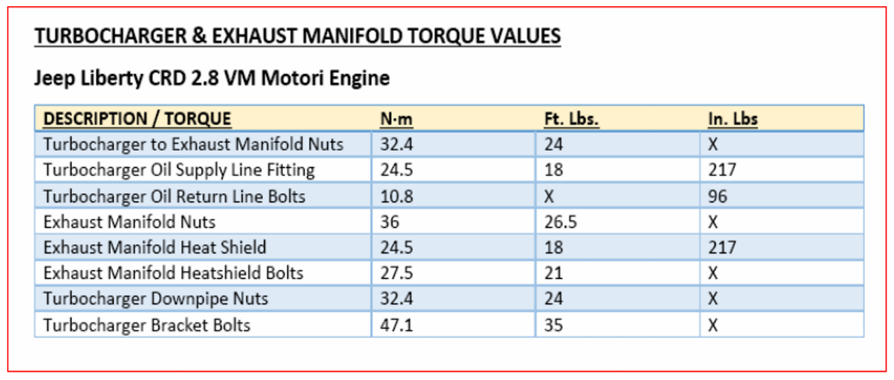

Does any one know torque specs for turbo install?
 Post subject: Re: Turbocharger installation
PostPosted: Fri Jan 21, 2022 2:48 pm
Posts: 7390
APC9199 wrote:
Does anyone know torque specs for turbo install?
From the FSM:
:wink:
