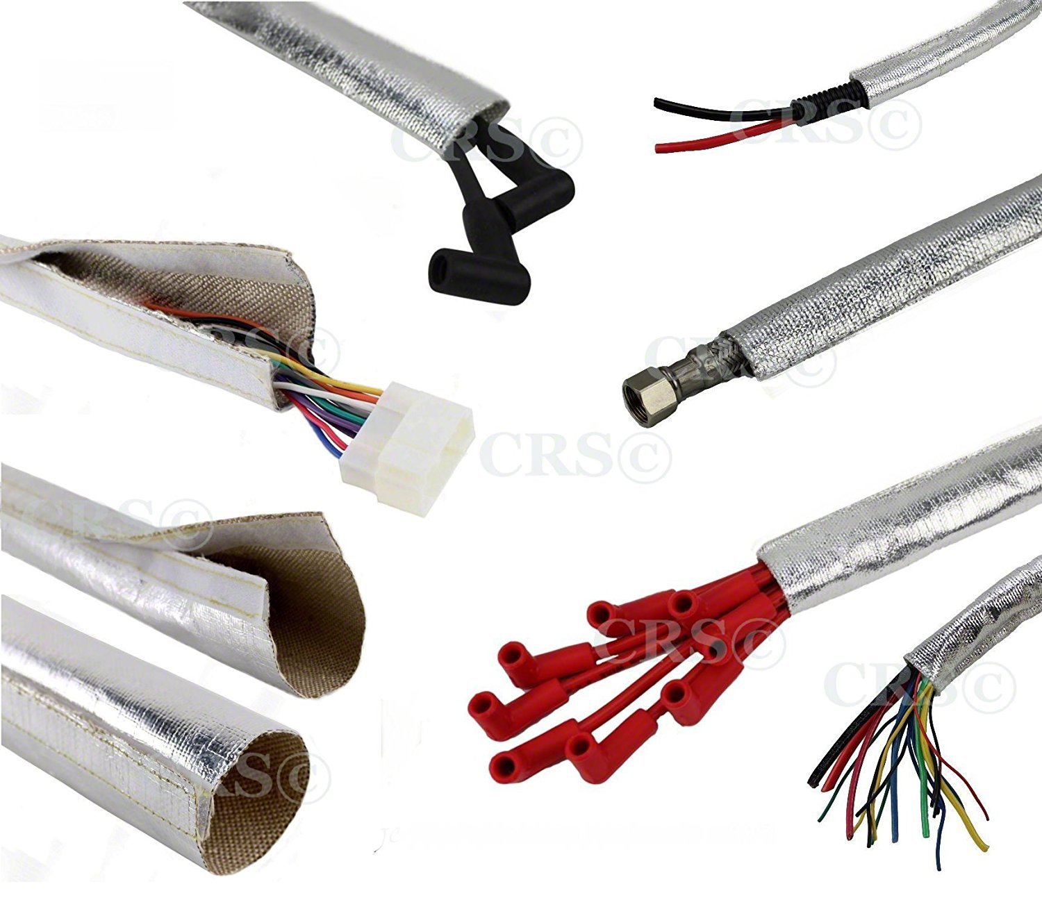

I wonder if my electric fan (much less air movement) will bite me in the rear in the future due to cooked wires. I removed the engine cover after seeing higher mileage CRD (with engine cover) with seriously baked wiring.
If you are concerned about the heat, you could always install Aluminum Metallic Insulated Covers like these.
They are relatively cheap and easy to install. They use velcro seams.
3 foot for $14 on Amazon.
https://www.amazon.com/Aluminum-Metalli ... B077JG6WJD

another reason to run w/o the top engine cover, maybe a little less heat?
I imagine another X amount of years, and this area is going to be a prime source of :banghead: and under hood fires. I can't wait. :roll:
This pic brings a tear to my one good eye.. I am soooo far away from this in my project...
I like that Parker product.
Stumbled across this picture of like a wiring protector on top of the engine. Very interesting.... :shock:
Study it closely!

.........looks like a nice way to repurpose an aluminum cookie sheet.... 8)
