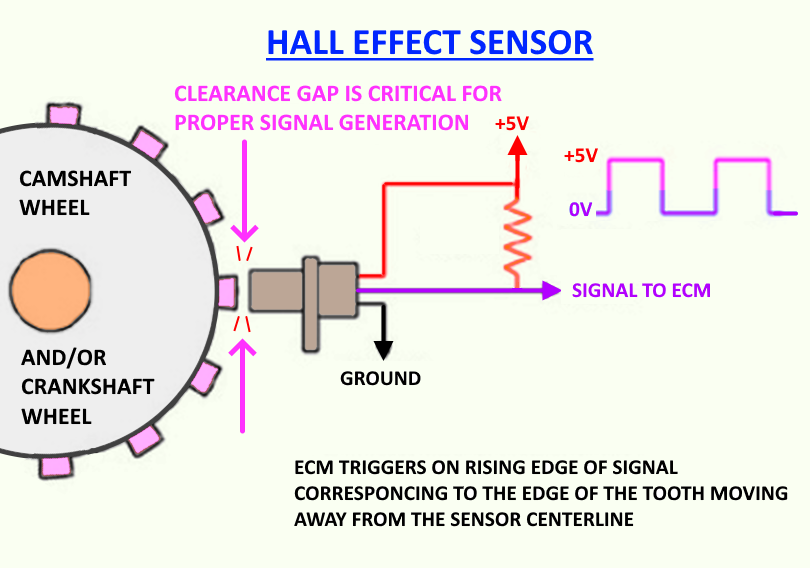

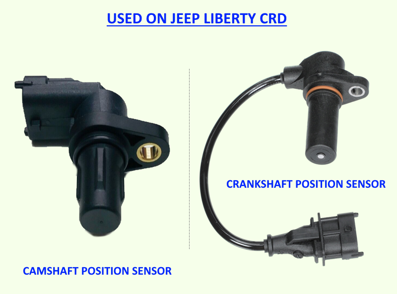

So, the culprit..... the frickkin camshaft sensor was installed incorrectly!
The garage my Jeep was towed to didn't push the sensor all the way in, continued to tighten the bolt.
Cracked it but didn't notice?!
By the looks it was ~5mm short. :banghead:

That's a new one to add to the list of things to check on a no start. Don't believe anyone has ever reported that issue before, you are the first that I know of.
Will add that to the list of what to check in a "no start" condition; check your cam sensor and make darn sure it is fully seated.
The same would be true for the crankshaft sensor as they both must have very close proximity to the trigger wheel for the hall effect sensor to function properly and produce the desired and proper signal for the ECM.
