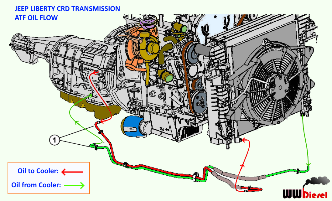

Do you have good air flow through the radiator stack? Is everything clean externally on the radiator stack. Are both cooling fans operating properly, mechanical fan clutch in good shape etc... Any of these problems can cause improper cooling issues as found and reported in the past by owners on this forum.
Stoppage of the fluid flow through the transmission cooler is not something that I can remember anyone reporting on before. Pretty much unheard of that I can remember but certainly not impossible! Weird problems can happen. :shock:
200 degrees fluid out of the transmission going to the cooler on a hot day is very normal if you are working the vehicle. I have a Tee block in my fluid line to the the cooler which allows me to read fluid temperature going TO the cooler and another sensor in the transmission pan to read fluid temperature after it has been cooled. When driving in high 90's especially pulling a loaded trailer, it is normal to see 200+ on the fluid temperature going to the cooler, and 180 in the pan. I have a switch that allows me to switch between sensors using only one gauge.
IF indeed you are having low flow issues on the cooling system, it could be from a problem inside the transmission; filter loose or stopped up, front oil pump failure, etc... The nipple that the screw on fluid filter inside the oil pan is made out of plastic and there have been some reports of that nipple cracking or breaking off allowing loss of fluid pressure. There are metal ones available to replace the plastic nipple. See picture 1
You could remove the cooler lines where they are connected to the side of the transmission and blow air into one of them and see what comes out and what the flow rate seems like. See picture 2

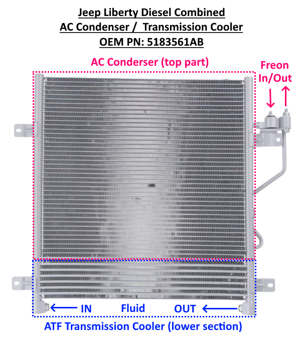

The transmission cooler is the lower third of the combined AC condenser/transmission cooler as pictured below. See picture 3
PICTURE 1
PICTURE 2
PICTURE 3

It's extremely hard to get to those lines there and I wasn't able to get the top line to clear the side of the body cavity up there, and exhaust pipe makes it very hard to do anything, how frustrating. I'll see what I can find from the front. A clear tube between the lines and running the engine will tell me a lot. They aren't easy to get at either it doesn't look like.

Yea combined into condensor, 10-4. Thanks!

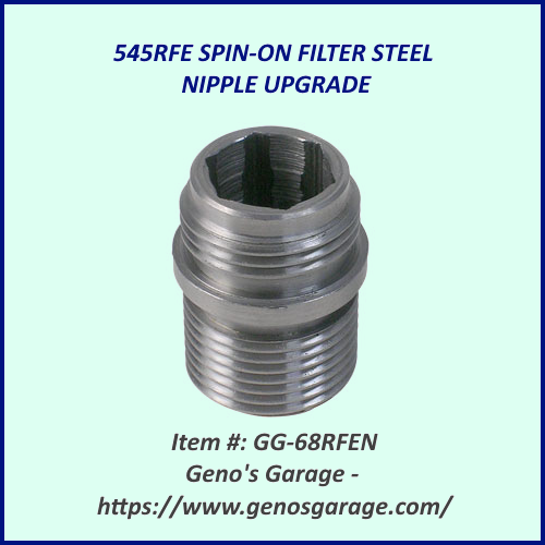

TRANSMISSION PAN - PML 545RFE
https://www.genosgarage.com/product/PML ... ssion-pans

That is for the 68RFE will it fit the 545?
Did you tap / drill the “boss cast into pan” for your sensor?

That is for the 68RFE will it fit the 545? All RFE transmissions use the same bolt pattern/pan, 45RFE, 545RFE, & 68RFE.
Did you tap / drill the “boss cast into pan” for your sensor? The pan came already tapped, did not have to do anything but bolt it on.
