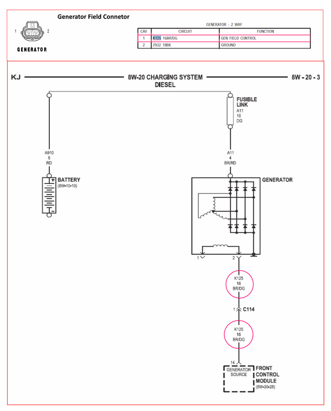

I fully agree with all that you said. Tell us more about that $50 oscilloscope.
Got my attention! One tool that I don't have in my arsenal but would love to have one.
They certainly have their place and usefulness when working on electrical issues on todays vehicles.
Nice article, but not fully correct for our 05 & 06 Jeeps. No surprises there! :lol:
It says Chrysler did not start using a "one wire" control until 2008, we know this is not true for our 05-06 applications.
None of the wiring schematics shown in the article (3 - 6) are correct for our Jeep diesels. May be true for some Gassers?
Has anyone tested for a PWM signal on the one wire on the voltage regulator at the alternator?
It would be very interesting to know what that signal looks like traveling through that single wire.
Such a true statement: "it seems the Liberty CRD doesn't behave like typical Mopars in most ways" :banghead: :cry:

There are things like this:
https://www.amazon.com/dp/B009H4AYII
I use specifically this one:
https://www.picotech.com/oscilloscope/2 ... 0-overview
which is quite a bit more, but since I really don't know what I'm doing most of the time, I wanted to have good software and quality documentation to fall back on.. Pico often assumes the user is an idiot like me, and they have howtos on how to test a variety of common automotive sensors.
In the intervening years, things like this have started to appear:
https://www.amazon.com/dp/B08DG1C129/
and I've been tempted to try one. For what I need, high accuracy isn't *super* important - with automotive sensors you're generally looking for patterns so I think something like this would work great. And not having to drag my laptop into the garage would be a plus! But until the darn CRD stops bleeding me dry, I can't even think about it. :D
I would *think* most modern multimeters can measure duty cycle, so assuming my theory on operation is correct (and I'm *reasonably* sure it is) you should be able to throw a multimeter in % mode and read that wire. I don't know whether the control is + or -, but that would only take a moment to determine and swap the probes around. On some (most?) multimeters polarity won't even matter.
The gotcha is that without specs, I'd think it tough to correlate what you read with anything truly useful. The control module just says "gimme more" or "gimme less" based on its algorithm. Without knowing that algorithm, you'd never know if what you saw is correct or not for current conditions. Also, it'd be impossible to determine the functional max value ... like, is 50% duty cycle enough to get full performance from the alternator, or is 100% duty cycle required?
Just a WAG here, but probably the even though the dimensions are unique to the CRD, the alternator itself shares operational attributes with a bazillion other alternators. If the "family" is known, probably how it works is documented somewhere. That's true of Bosch, GM, and Ford... I'm sure it's true in Mopar-land too.

Hopefully this video will settle the alternator/regulator debate:
https://youtu.be/8LPgLwTLilY
The alternator WILL self excite without any input from an external module.
When I replaced my voltage regulator I dissected the old one.
Inside I found an integrated circuit and two capacitors.
It was the capacitors that caught my attention.
I’m not an electrical engineer nor an automotive engineer but here is my theory of operation:
As long as those capacitors have a charge, the alternator will excite and charge all in its own. However, if left unused for a long period of time the capacitors can drain and will need an external input to get it charging again.
This is definitely true with a NEW regulator that I verified. But I only verified at idle and didn’t verify exactly where that one small wire gets it’s voltage from.
It’s also possible that the alternator will self excite at a certain rpm above idle, just like the good ol GM 1-wire alternator.
But I couldn’t verify that.

I think this is typical operation - without any intervention from the control module, the alternator goes to full charge. The caution here could be what that Remy article suggests - that charging voltage may go very high as rpm.increases in this situation. Or, it could behave like a GM alternator and simply run at 14v. That's how the alternator in my Fiero is wired... The computer control is simply not plugged in. It self excites, I get 14v.
I think the only point of this tangent was to demonstrate that jagster's low speed voltage fluctuation could be the result of the control module getting bad information and/or poorly controlling the alternator. If we knew the answer to the "uncontrolled voltage" question, we could advise disconnecting the control wire and seeing if the problem goes away.
I don't think it will... I think the issue is either the VR or the alternator itself... But wtf do I know?
