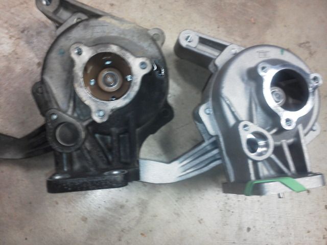

Ok, I need help again.....
What's up with my old water pump? And what do I do now? Look at the pic, tell me why the little hole, left lower of the big hole, is open on the new pump? Old one is sealed and not machined open like the new one, and the threaded hole is not threaded on the old pump... And its not a plug. Now what do I do???? Kinda stuck til I figure this out

Swap the rear halves of the pumps?

I just swapped back halves. Only feasible option I had so I ran with it. I was wrenching and needed to keep moving.
