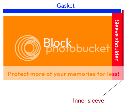

I don't think the liners are ever supposed to actually contact the head. I think you're right about the fire ring (i.e. protecting the gasket from the bulk of the radiant heat, turbulence, etc.), but I don't think that is the source of the seal. Here is my understanding of the way the gasket is supposed to seal in this engine:
The "sleeve shoulder" shown here can be at or slightly above the block surface because that is where the gasket seal faces the highest pressure differential. So "slightly above" as in .05mm is probably an advantage as long as the gasket can also seal everywhere else. But the thickness of the gasket still needs to place the head surface slightly above what I've labeled the "inner sleeve" so that the liner doesn't actually hit the head. That inner sleeve is just a part of the liner that was not machined away as far as I know, not actually a separate piece of metal. So, as I mentioned earlier, I suspect that if you compare the rings that you see on a used head with the diameter of the head gasket, you'll find that the rings match up with the gasket, not the inner sleeve of the liner. Hope this helps somebody, and if I'm wrong I welcome information that is based on something other than opinion.

That's a great visual.

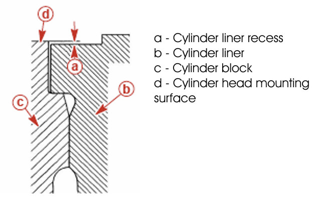

Disclaimer, I am no expert nor have I ever been in one of these engines beyond the timing belt/water pump replacement. What I have found does support what others have stated to some degree, below is the technical side of this discussion for those interested:
This information is from a VM Morori engine manual and I think in theory the requirements are very similar?
BASIC ENGINE Cylinder head GASKET
IMPORTANT: When cylinder heads are removed for service but pistons and cylinder liners are not disturbed,use
the same thickness gaskets that were removed. Refer to Head Gasket Identification.
Refer to the following procedures during a complete engine rebuild or when pistons and liners are being replaced.
1. Use the dial indicator and Support Block tool (liner gauge bar) to measure piston height above the
cylinder block with the piston at Top Dead Center (TDC ).
2. Place Support Block on cylinder block surface and set the dial indicator to zero 0.
3. Move the Support Block tool to the piston surface with the piston at TDC point as shown.Record the measurement.
4. Measure the piston protrusion (height) of all pistons. Use the average measurement to determine the gasket thickness
required for all cylinders.
5. After determining the head gasket thickness required, identify and select the proper the cylinder head gasket.
Note the identification marks (holes or notches) in the lower right hand corner.
No mark indicates a thickness of 1.42 mm
Two marks indicate a thickness of 1.52 mm
One mark indicates a thickness of 1.62 mm
Cylinder liners on all engines are required to protrude, or rise above, the surface of the cylinder block!
CAUTION! Cylinder liner protrusion can only be correctly measured with the cylinder liners fully seated in the cylinder block. Incorrect measurements will result in engine performance problems or severe engine damage. Ensure the cylinder liners are fully seated in the cylinder block before measuring cylinder liner protrusion.
NOTE: The cylinder liners will rotate freely in the bore when the cylinder block and cylinder liner are completely clean and ready for measuring cylinder liner protrusion.
a. Unless being replaced, install the cylinder liners in the same cylinder block bore without O-rings as marked or noted upon disassembly.
b. Using a precision depth gauge measure and record the amount of cylinder liner recess (the depth below the cylinder head mounting surface of the cylinder block) of each liner.
1. Use the dial indicator and Support Block tool (liner gauge bar) to measure the liner protrusion above the cylinder block..
2. Place Support Block with the dial indicator feeler gauge on the cylinder block.
3. Set the dial indicator to zero (0).
4. Move the dial indicator to the liner on the liner neck. Record the measurement.
5. Measure the liner protrusion of all liners.
6. Verify the amount of liner protrusion for each liner as specified:
Cylinder liner protrusion- 0.0 ÷ + 0.07 mm
