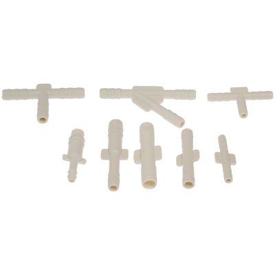

You can purchase high performance silicone vacuum hose on Amazon or a Summit Racing in many different sizes.
https://www.amazon.com/High-Performance ... B009PYDSD8
All that is needed to go from 5mm to 7mm is either a plastic or metal reducer adapter available at most any hardware store or builders supply like Lowes or Home Depot.

this is a vacuum hose connector adapter kit like I was referring to. (picture)
Both Autozone and Amazon both have the hard plastic as well as the soft rubber elbow vacuum hose reducer adapters.
Yep. And it looks as though I may have been wrong about the need for the reducers.
