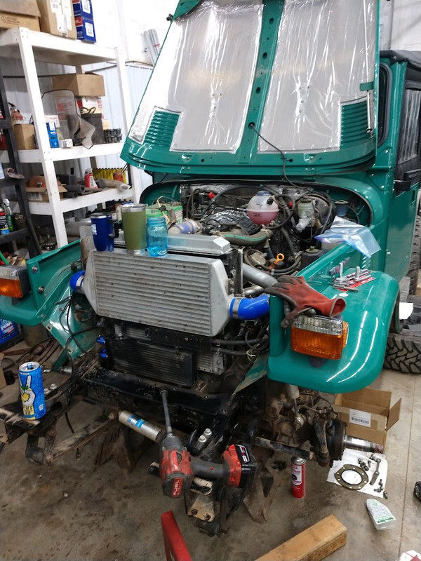

Well she looks a little rough right now. But they are both getting their hearts taken out..
And this one..

Making progress!
I hope nothing was harmed during that wire explosion on the KJ...
Is that sound deadening or insulation on the FJ hood? Or both?
As for Steve777, don't the 2005 & up EVICs just sandwich to the headliner? Thought I read where the older models had the plastic piece stuck to the roof. The one I just pulled from a 2005 is the sandwich style.

krb wrote:
Making progress!
LOL. No sir. No wires that I needed were harmed in the removal. I will need to shorten a tonnnnn of wires. I did buy the ends of the wires already, I will take 1 at a time out of the plug and shorten... and repeat...
Yes, sound deadening/insulation combo.
The CRD is out and cleaned up. The VW will be out tomorrow. Been taking lots of measurements as it has been coming out. I believe that the CRD is gonna fit in the engine compartment of the 40 way better than the VW did!!
