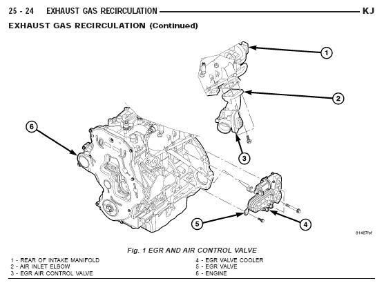

I can find the EGR but can't get my hand or screw driver to the plug. If I am tring to unplug the right thing. It is under the FCV, right? :?:

Yes, the EGR plug is underneath the FCV valve. If someone here can post a picture, I can email them the diagram from the shop manual to post for all to see. I don't have a place on the net to post pictures.

Here is the picture:
Image[/img]

And I still can't get my hand on the plug to unplug the EGR valve. :evil: . I got the FCV unpluged.

KJMedic - If you look between the motor and the intake hose (directly behind the flow control valve) you can see the connector. I was able to stick a long, skinny screwdriver down through there and finally pop the thing loose. It's a pain otherwise.
