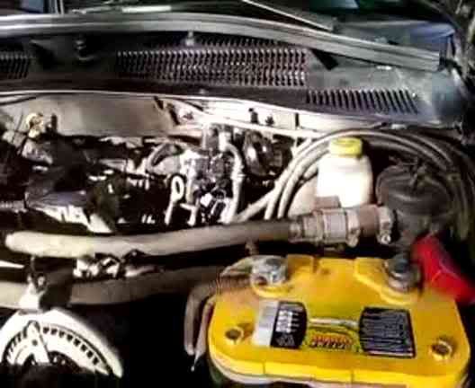

Here's a thought - the EGR pipe runs around the back of the engine and enters the intake on the bottom driver's side. Is it possible that if the EGR pipe broke at the intake end, that it would make that sound? And would it cause it to run like that? (My first thought watching the vid was exhaust leak at the manifold) Bub is running the SEGR too, though - how would that affect exhaust gas even entering the pipe?
There's a pic on here that Sir Sam posted of the side of a 2.5 CRD, should look pretty much the same as a 2.8. Lemme see if I can find it.
Here it is, you can see where the EGR pipe enters the intake just behind where the CAC hose fits on:

Here is a video of the engine running.

Play Bub's video, take a step back from the speakers. It sounds like a petrol engine that spit out a plug. I am so thinking injector seal..
Disconnecting the injector should not make any difference if indeed the N#1 is leaking. IF there is a leak there is no or very little compressed air in the cilinder so no or very poor combustion.
That's the part I don't get. Unless the N#1 is the only one that is not leaking...Image
New idea...take out the injectors and crank it. If the cloink sound is not there, we found it. If it still cloinks, we didn't... :|
