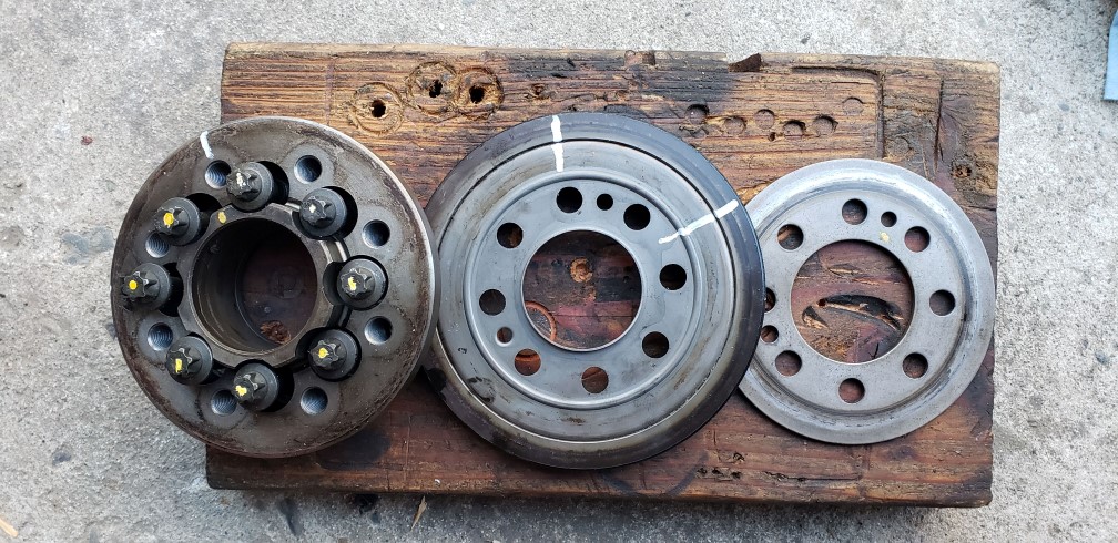

Here is how - it appears - the things bolt to the rear end of the crank:
The thrust washer (o-ring is on the other side) sits against the crank flange, then the RMS, then the flex plate adapter. What's interesting to me is both the RMS and the thrust washer have sealing features, so the RMS seals against the thrust washer and the thrust washer against the crank flange. That's a lot of sealing.
The FSM indicates the preferred method to install is to remove the rear carrier, install the RMS into the carrier, then put it back on the motor. I'm sure that makes for a fun time aligning the holes in the crank flange, but the motor is out so no worries.
This is making sense to me.... so hopefully I have it right. :)
The only thing I'm struggling with is whether the RMS spins within the rear carrier, or whether the center section of the RMS rotates against the seal surface. It doesn't really matter, I suppose, I'm just curious. :)

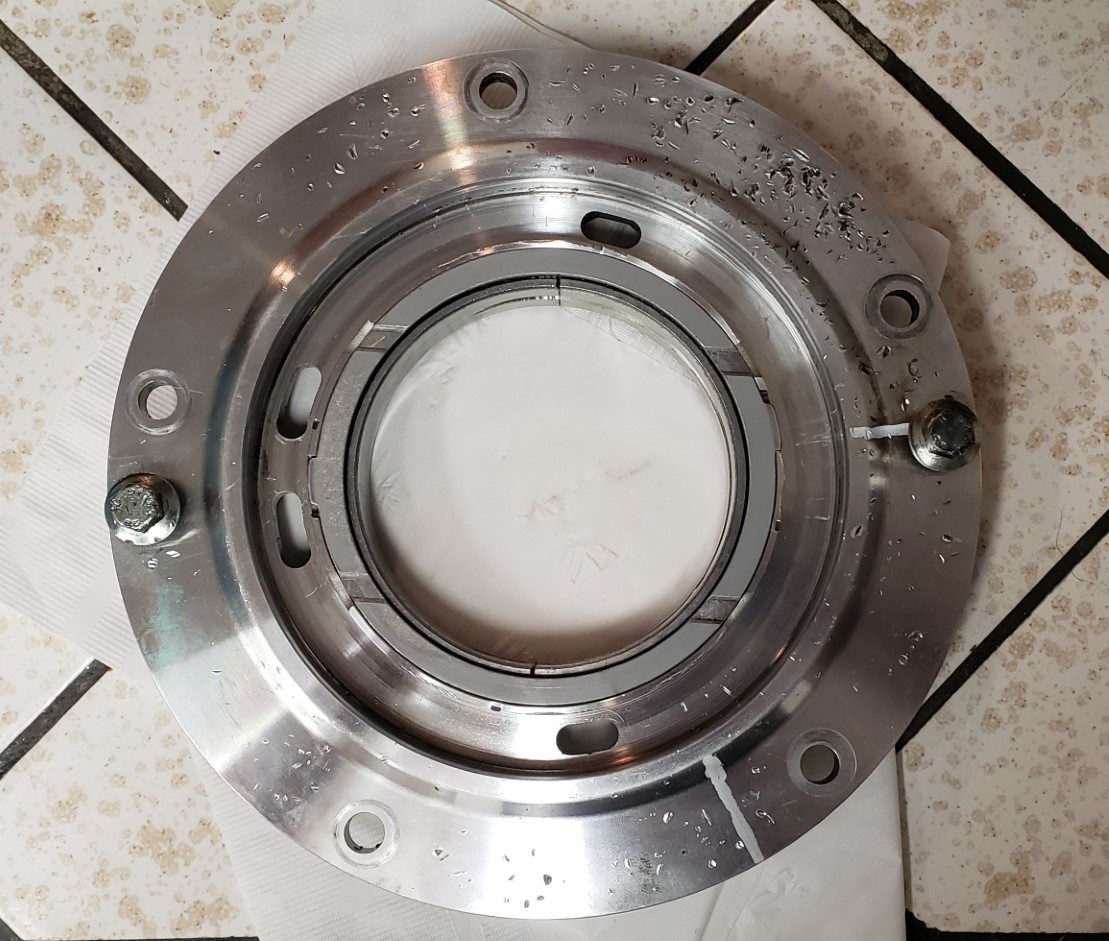

[quote="thesameguy"]Some more nitty gritty stuff... :)
Here's the outward-facing side of the carrier:
Something I hadn't noticed before, but flange on that left-side bolt is chewed up. It reaffirms the concept that *that* bolt was bouncing around in there and that's what chewed up the carrier.
I've found those bolts loose or missing on more than one of these engines. I blue locktite them, along with harmonic balancer, and some other bolts that are commonly found loose.

The guy who I had do the RMS really seemed like an attentive purpose, and he was really a pleasure to deal with. When I picked up the car he had already put 20-30 miles on it (drove it home one night & back) and there's no way it could have been leaking. I made it probably 20 miles before it started leaking again. I *love* the idea that maybe these bolts are just prone to coming loose, and that wouldn't be far-fetched given all the damage, the re-appearing leak, and me finding them loose AGAIN.
If nothing else, it's great to hear it's not a unique problem... I will *definitely* threadlock them in. I just can't help but wonder *why* they're prone to this.... what in the design should be different to keep a darn main bearing carrier in place. Maybe an errant torque spec? Wrong fastener? I hate the idea of burying a potential problem. :|

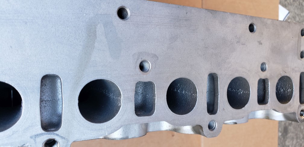

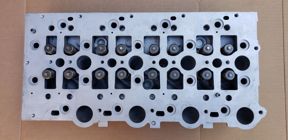

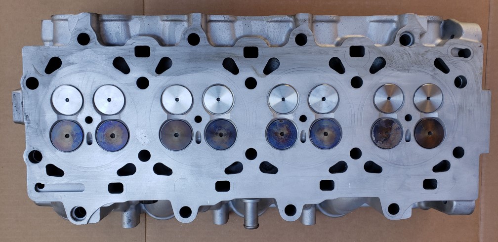

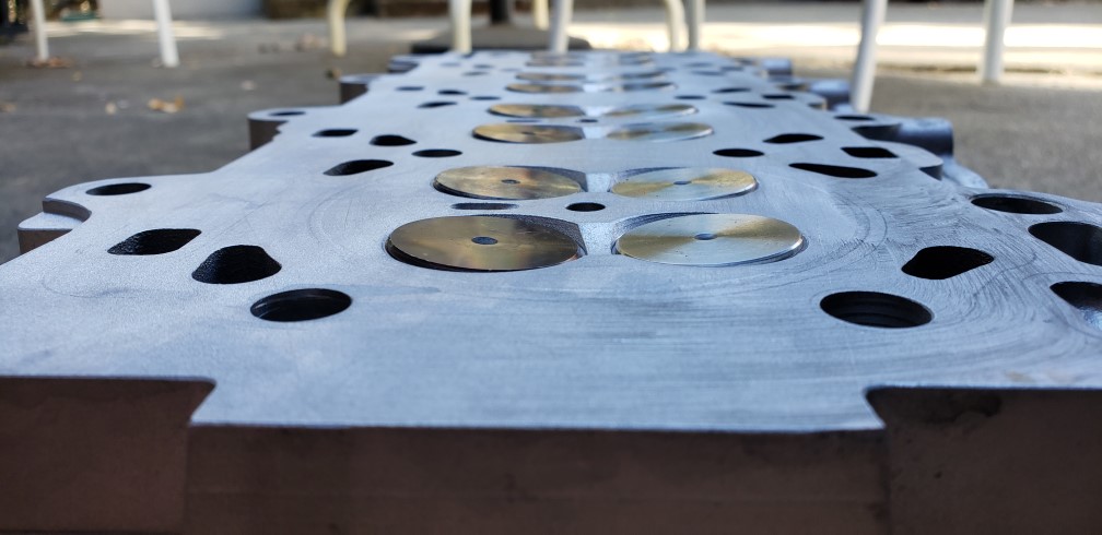

Picked up the finished cylinder head...
8x new intake valves (five were bad)
8x new exhaust valves (preventative)
16x new valve guides (most were worn)
2x new valve seats
1x crack between valves welded
2x broken studs extracted
The good news is that it was 100% flat, so just wear and not damage.
I have questions now about the "broken exhaust valve" syndrome. The shop indicated they found nothing wrong with the valves themselves, but the guide wear was pronounced, especially on the exhaust side. Multiple valves - including FIVE of the intake valves - were wobbling in their guides. They had been wobbling long enough that reusing them wasn't an option. My guy at the shop - who I've been using since the '90s and have done probably 50 heads for me - said he was surprised valves hadn't already broken. My personal takeaway from this one sample is that replacing valves without replacing guides is throwing good money after bad.
Here is what came out, for whatever it's worth:
And here's what I've got now:
NICE!
The interference on this engine is bonkers to me - but man, there isn't much shroud on those valves!
I'm less impressed with the casting. If I had more motivation, I would smooth this out. But I've got bigger fish to fry, and no performance aspirations. Just, really, I would expect better from a modern aluminum head:

I think you're talking about the 2 oil slingers. And then there's one thrust washer. They're aren't any other metal parts.

This thread has a picture of the slingers.
viewtopic.php?f=5&t=85343
The mistake that at least two of us have made, is where the thrust washer is left out because it hides, stuck to the old seal housing (metal part). The result is the crank won't turn, and the $50 seal gets destroyed...

Thanks for that - all three of those components are accounted for!
The fitment of the slingers is nifty... the one thing I notice is that one of them can rotate about 5 degrees or so... I cannot tell if the carrier is designed that way or it's worn. It doesn't appear to be a problem, just an interesting detail.
