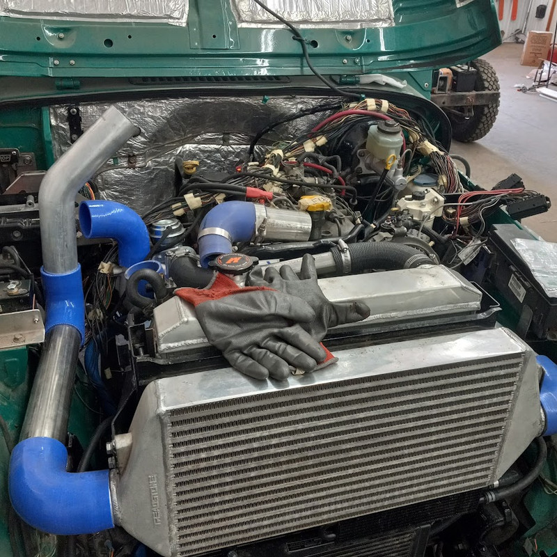

Got the Liberty/FJ40 on the road this last Thursday. Put a few hundred miles on it this weekend!! Extremely happy with the power and performance so far. I have a few bugs to work out, which is to be expected...
One question I have for you guys is I have an UltraGauge display that plugs into the OBD port. I have 2 of these units so I know they are both good. I have verified in other vehicles. But on both my 05 Daily driver Liberty and my 05 Liberty/FJ40 conversion, after about 20 mins(roughly-and it varies) the unit shuts off. It acts like the Liberty computer is turning something off... not sure what that is... I believe it looses communication.. Has anyone had any experience with this? Or have any idea which wire that might be?
Here it is the other day almost on the road!!
And here it is after the first test drive!!

 Post subject: Re: 2005 CRD swap into fj40
PostPosted: Mon May 30, 2022 3:56 pm
Posts: 7390
Sweet, love the conversion, know you will enjoy it.
As to your question, it is data bus overload according to what I have learned and read. The Jeep Liberty Diesel uses a (PCI) data bus system.
If communications with the Data Connector Module you have plugged in become overloaded, the ECM will default to a non-communication mode to protect the more important functions of the ECM for operation of the engine.
You may want to try some different data monitor connectors and find one that does not overload the data highway.
A hardwired bus connector may be better suited for full time communication?
Maybe some others on here can chime in as to what they have had good success with....

Thanks!! So far I am really impressed. I hope to get some bugs wrapped up here quickly and get some mile on it this summer! I was hoping to post a lot more, but it was a hard push to get it in and running this winter.
Good to know about the PCI bus. Yes, I hope others share some more data on a workaround. Thanks!

I have not built my airbox yet. That is next on the list. And I want to keep the intake clean!!
Hopefully I will cool the intake temps a lot with the airbox. At least that is my goal...
On the motor I took out my intercooler was doing its job. VW took intake temp just before entering the motor. And my intake temps were 1.5-2 degrees F of ambient temp.
