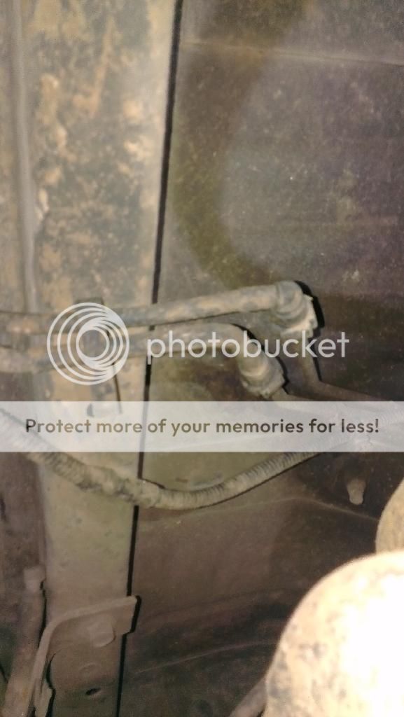

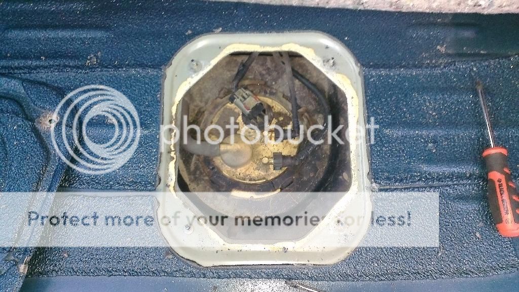

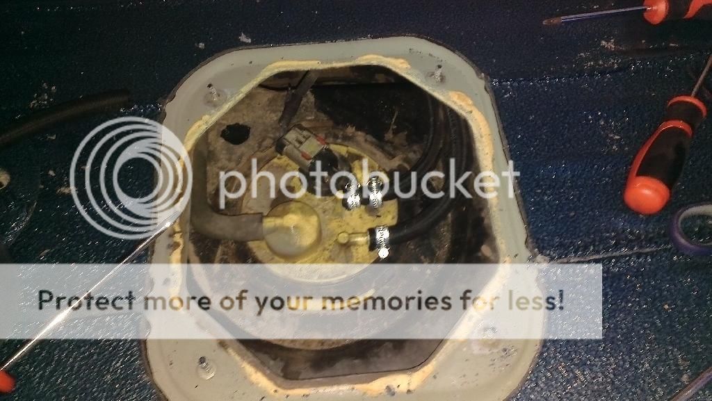

Today I replaced the crappy tank lines with thier quick clips with new diesel lines with hose clips. Getting the tank access plate off was the hardest job, removing the rear carpet & chipping away all the frame sealer over the nuts took ages.
Where the lines meet the solid pipe. Will mount the electric pump here.
Hose all replaced, return is 7mm and feed is 8mm, put 2 clips on the return just to be safe.
Bled up okay, will see if air gets in now. Still plan to fit the electric pump even if replacing these pipes fixes it.

Those of us with later model KJs would kill to have the problem you had getting that access plate of. DCJ deleted it on later models so the only way to get to the fuel tank sending unit is to drop the entire tank. Beyond stupid.
