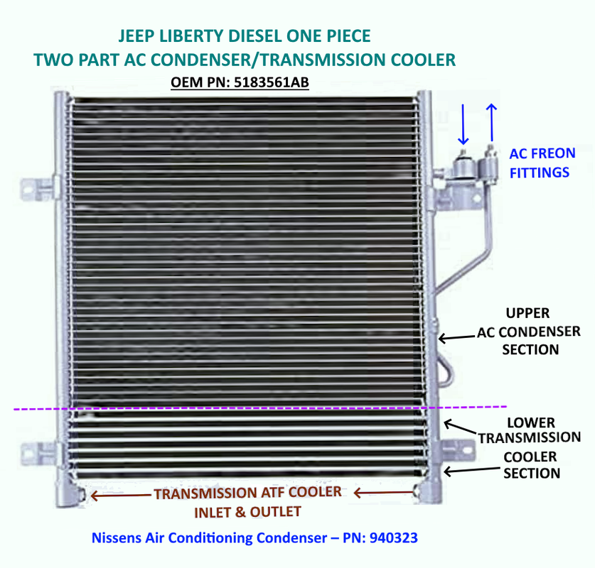

You can purchase a brand new OEM style Nissens A/C condenser/transmission cooler from Rock Auto for $155 + shipping.
Installed one for a customer a few weeks ago and and it was a very well made replacement part; fit and functioned perfectly. :D
If you are going to abandon the OEM transmission cooler completely, then you need to install a large replacement ATF cooler to ensure adequate cooling.

It seems like the one I bought is nearly the same size as the stock one at the bottom of the condenser, only its more square rather than rectangular. The Hayden 698 is meant for large trucks that tow 5000lb or more. I'd assume this is all I need since I don't even tow things normally.

Also the stock cooler is 20x5 inches. The new on is 9x11. Overall it is basically the exact same size as the stock.
