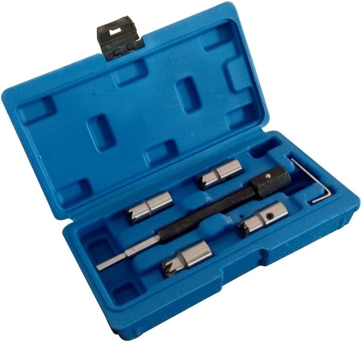

in order to seal the injector copper washer into the injector cup, you really need the specific tool and its relatively cheap. its called 'injector cup cutting tool.' we've mentioned it before and even wwdiesel had some nice picture of the tool sending it to everyone.

quick update and we just pulled the fuel injector and its blow-by. As in the new o-ring and copper crush washer were black in most of the area. We cleaned up the bore spotless. Has anyone had the head crack where the fuel injector sits? Its driving me nuts.
 Post subject: Re: Stuck #4 fuel injector
PostPosted: Sat May 22, 2021 9:20 pm
Posts: 7380
Get a set of fuel injector seat reamers and clean everything up.
Available on Amazon and eBay for cheap.
