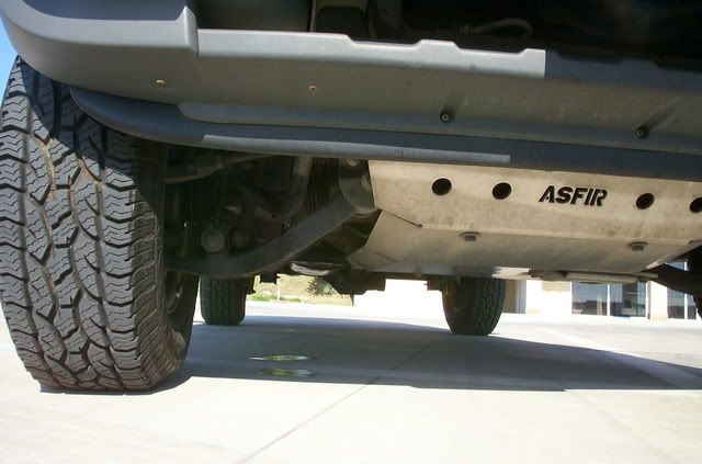

Went with the 235/75/16 to get the most height increase with no rubbing...29.84". I had no rubbing issues at all AND they look good even after a 2.25" lift.
Hercules Terra Trac ATs
