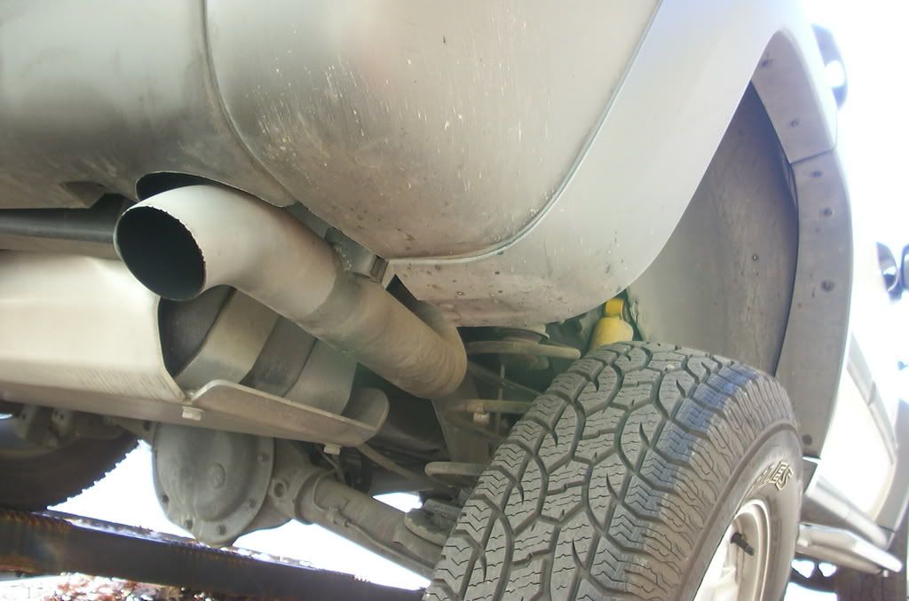

3" Exhaust with no muffler:
Tailpipe a bit longer:

what i did was :
original:
tail pipe section,---arround axel ------ muffler --- flange ---- cat --- flex pipe---- turbo.
mine:
tail pipe section--- arround muffler------ 2.5 id pipe -- welded 2 2.5 exhaust tail pipes --- cat --- flange-- flex pipe --- turbo.
The flanges that atach the mufler and cat originally are a botleneck. so i cut them off. I used slip on pipes from autozone and exhaust camps to conect my welded part to the tail pipe section and cat. So if i want to take it off and add a diferent muffler i can easly. But i probably wont cos i think is ok.
I just started welding, and this pipe was like suck booty soft, so my welds are horrible ! no laffing allowed :)
Pic of the flange:
pic of the outside of flange, you can tell where the welds are how it chokes the pipe. is really clear on the inside pic.
pic of the 2 tailpies from autozone,
pic of the final result
Notice my riging finishes before the axel to use as much as i can of the factory bent pipe that goes from before the axel to the tailpipe !
