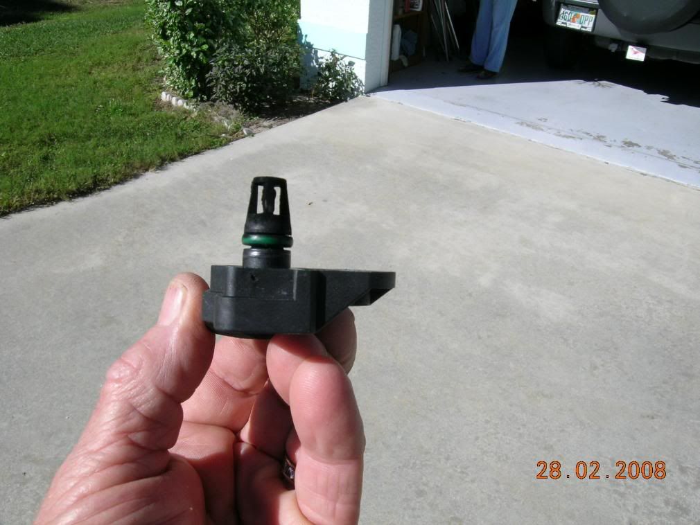

I cleaned the MAP today and it was hardly dirty.
History of this being clean.
Sept 07 22,500 Last cleaning
Nov 07 23,900 EHM
Jan 08 26,150 SEGR
Feb 08 27,645 Cleaned MAP

Looks good -- I'll have to check mine. It's been about 4k miles since I first cleaned my MAP and installed the CCV mod. And 2k since the SEGR was installed.

It's evidently getting soot from somewhere. Do you think that the coating on there is from before your mods? Your pic is about the same as mine looked after 10k with the ORM.

First post is mine and thats not after photo.
That is before I cleaned it. YES

i believe there will always be soot build-up on the MAP due to turbo bearing blow-by. The SEGR and CCV bypass will certainly aid but not eliminate our condition. again this is my belief which is based solely on my OWN observed situation.
The turbo blowby if any, will be an oily film not soot or tar.

nursecosmo wrote:
I would agree any blowby will be in the form of oil, but eventually that oil will foul our sensors, SEGR or not. I have been pulling my turbo to CAC tube regularly and notice an unusual amount of oil.

I'm done cleaning my MAP. I pulled it last week and it was virtually spotless with only a whisp of oil on it. Disabling the EGR and using a Provent CCV has fixed the problem as far as I am concerned.

I just pulled my MAP out today for a cleaning as the Jeep turned 10,000 miles since I installed the SEGR (46,000 total miles). There was just a light coating of oil on it, and not a hint of any kind of soot (like the previous cleaning before the ORM I did around 15,000 miles). I couldn't be happier! :D
Bottom line, a little over 30,000 miles without EGR, and everything is dandy.
