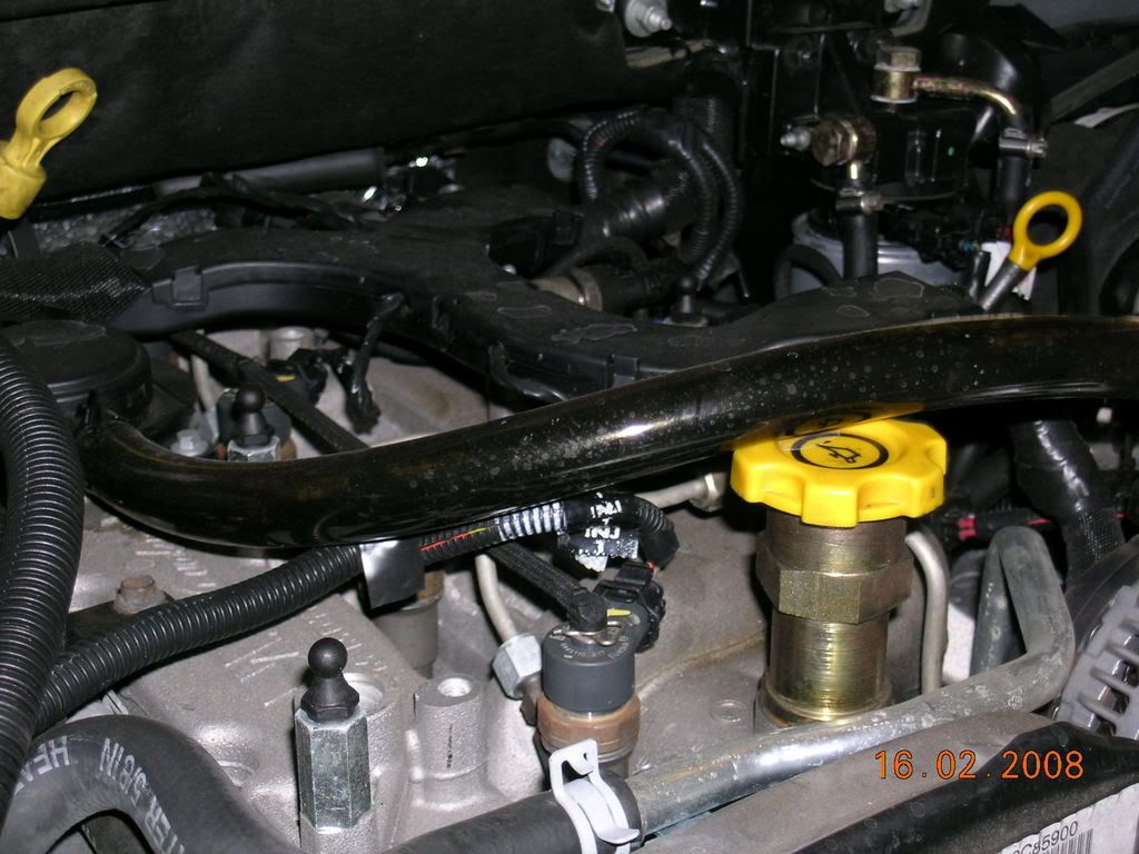

This my friend is what is coming out of your CCV puck. You can let it out or run back thru the system
Don't think so. That hose was clear. Provent or homemade is fine as long as this doesn't run
back thru you tractor.

That picture above has like 6,000 mile on it or so. Could pull
paper work and tell you exactly but it is still the same &&&. different day
My friend. that junk does not need to run thru your turbo, intercooler, hoses
etc.
