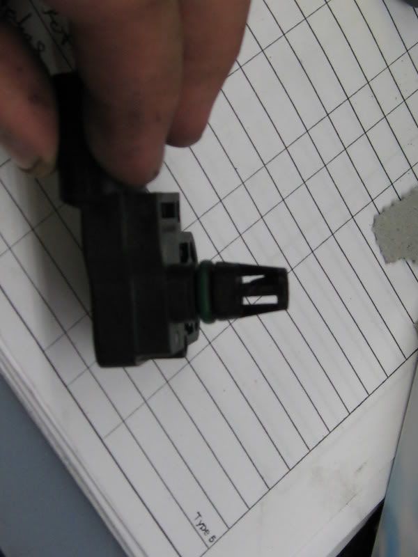

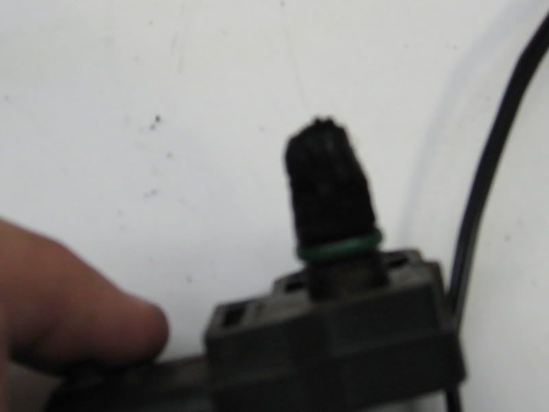

MAP sensor cleaning is the best thing you can do for fuel mileage. Here's mine before and after:
