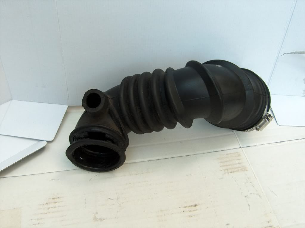

Far be it from me to cry 'wolf', but while investigating a suitable location for an EGT thermocouple probe, I found this:

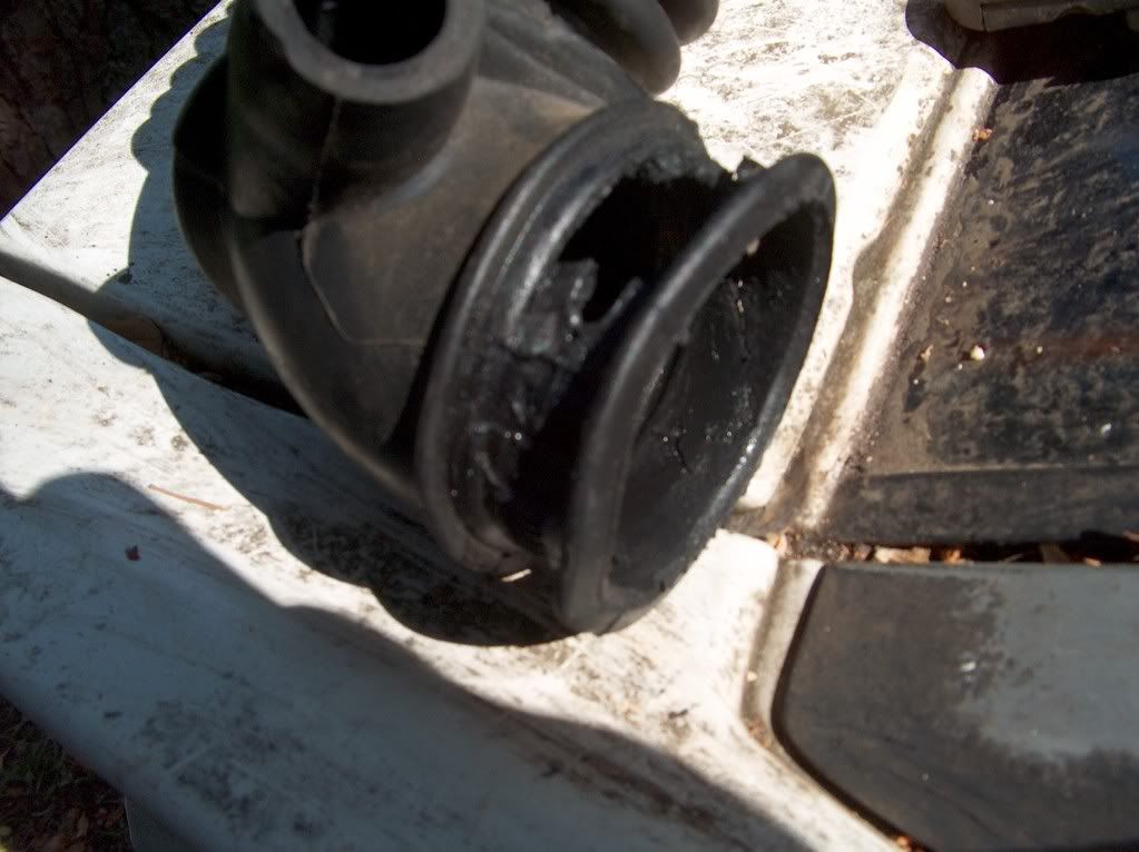

I sincerely believe, as the gynecologist said, that this bears looking into:
This is normal wear'n'tear for the compressor inlet duct at 68kmi, having been subjected to crankcase effluent for a good portion of those miles - it might behoove you guys to have a look at yours, as this won't play, clean air filter, or no.

Looks like we will be hitting mopar online for this part ......
Anyone find this part number or description?
Maybe samco will make one of these for us :roll:

53013104AC - $37 ur cost at DCPARTSONLINE should just about do it

FYI - I did kill one of those hoses - but I chalked it up to pulling the Provent for dealer service trips - but it looked just like that.
