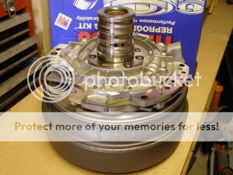

Got the Suncoast TC and pump.
Put them together... they fit....
Now to put em in the tranny !

Good show - now, if you wouldn't mind, flip the pump over and take a few clear shots of the modified hub area - the pics in the original post are quite blurry - please and thank you.....................

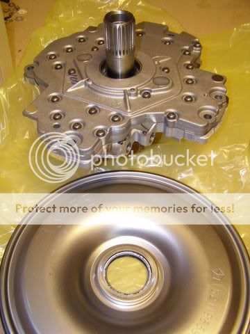

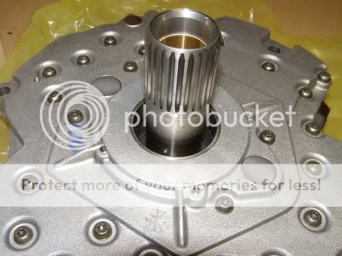

Here are the details of the redesigned RFE 545 pump
Sorry, GMCTD , have not pulled the old one out yet

Now, that is some clear - nice shots, Bill - as you can see, that is a new original casting, not the old original casting with the hub\collar removed by fly-cuttting - the large round cover now seals to the case and the torque convertor drive hub - those flat round shiny areas in the casting on either side of the stator shaft are the pins for the two pump gears - the pump is a dual-gear dual-output design - the TCM runs the output of both gears at low engine rpm to get good line pressure\volume, then a valve bypasses the secondary gear, running on the primary gear only as pump pressure increases due to increasing input rpm - some shudder can be caused as the secondary gear is valved in\out
You might disassemble the oem pump for some show'n'tell, if you have some time - that's all those torx stove bolts - I've been trying to purchase a pre-owned original-design pump for show'n'tell, incl machining off the hub for re-use, but no luck
That 52119559 is the p\n for the cover\front seal, needed when installing the TC on a used pump
