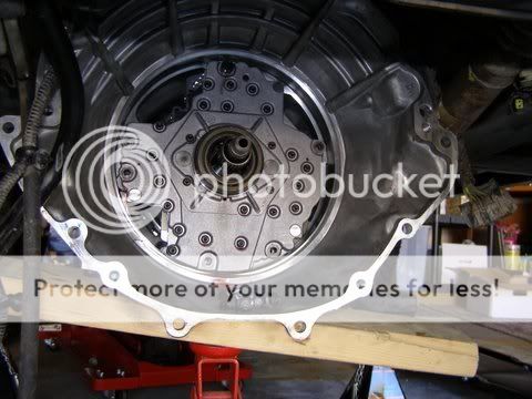

I did the installed the suncoast TC, new design tranny pump and transgo shift kit (valve body items only)
It took a lot of effort on my part doing a solo job. Two 12 hr days.
I will add more details and installation tips later
See photos

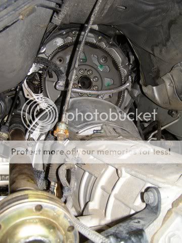

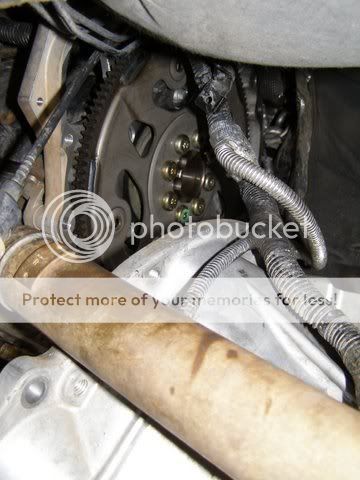

Note 11 bell housing bolts including very hard to reach top two (need 4 ft extension)
Flex plate accessed thru port above starter just out of view in this picture
Old tranny pump cover in place

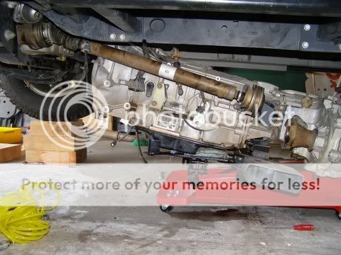

Cant get tranny out from under even with 11.5 " lift

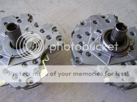

Pumps new and old side by side.
Old pump prior to removal

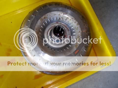

Old TC looking for new home

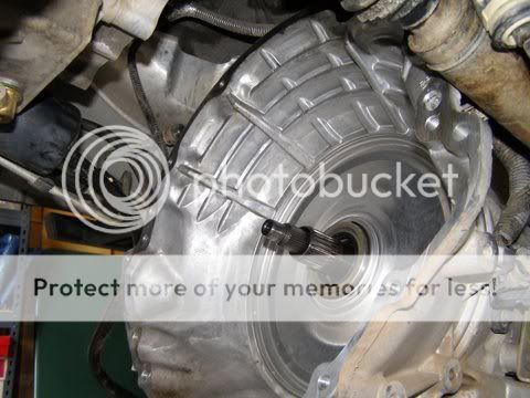

Pump removed. Carefull not to pull out shaft and mess up clutch plates!

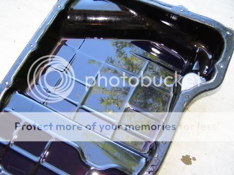

Pan was clean. I used a gasket that came with the new filter kit instead of RTV.

To summarize the research of others: Re-worked seals and some simplification of the sealing components that reduce the likelihood of of drain-back and seal leakage, especially on units that have been services and reinstalled. Basically: more likely to actually push the volume/pressure of fluid than the original units that are prone to tranny-internal leakage.

Right - you can have the original pump cover fly-cut to remove the original sealing collar, then it's the same as the late pump - you could see that very solution in the interim pumps, where that particular surface was very shiny from being machined after the fact - then you just need the new case cover\seal to complete the job
