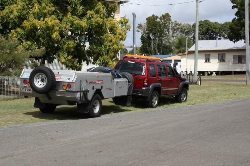

Have you considered air bags in the rear springs? I tow a camper trailer with an all-up weight of around 3,300lb and like you I have to use a long tongue turned upside down to get the hitch at the right height. With airbags in the rear springs inflated to 25-30psi I have no sway at all.
GME TX3440 UHF, Codan NGT HF
