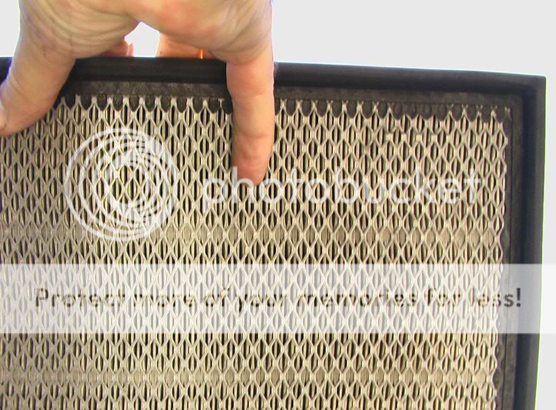

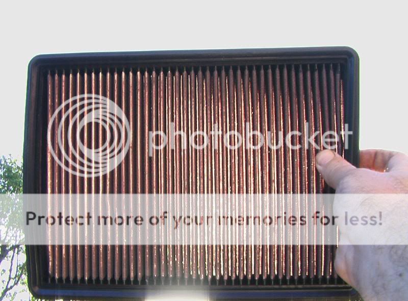

...Until I saw the day light coming through the holes in the media. Holes that are large enough to see light coming through the media like stars on a clear night is not acceptable. I ordered and installed ProGuard 7s for both my CRD and Wife's TDI.
I think that says it all, and that's why they flow so well, at the expense of passing airborne crap. I run one on my track racer, and. that's. it.

[quote="warp2diesel"]...Until I saw the day light coming through the holes in the media. Holes that are large enough to see light coming through the media like stars on a clear night is not acceptable. I ordered and installed ProGuard 7s for both my CRD and Wife's TDI.
I put the K & N through the light test :shock:
And then i took my paper filter out of the box...
After that excercise i packed the K & N back in the box and left the paper filter in the airbox.
Anyone want to but my K & N for 30 bucks shipped to any part of the world.... :lol: :lol: :lol:
