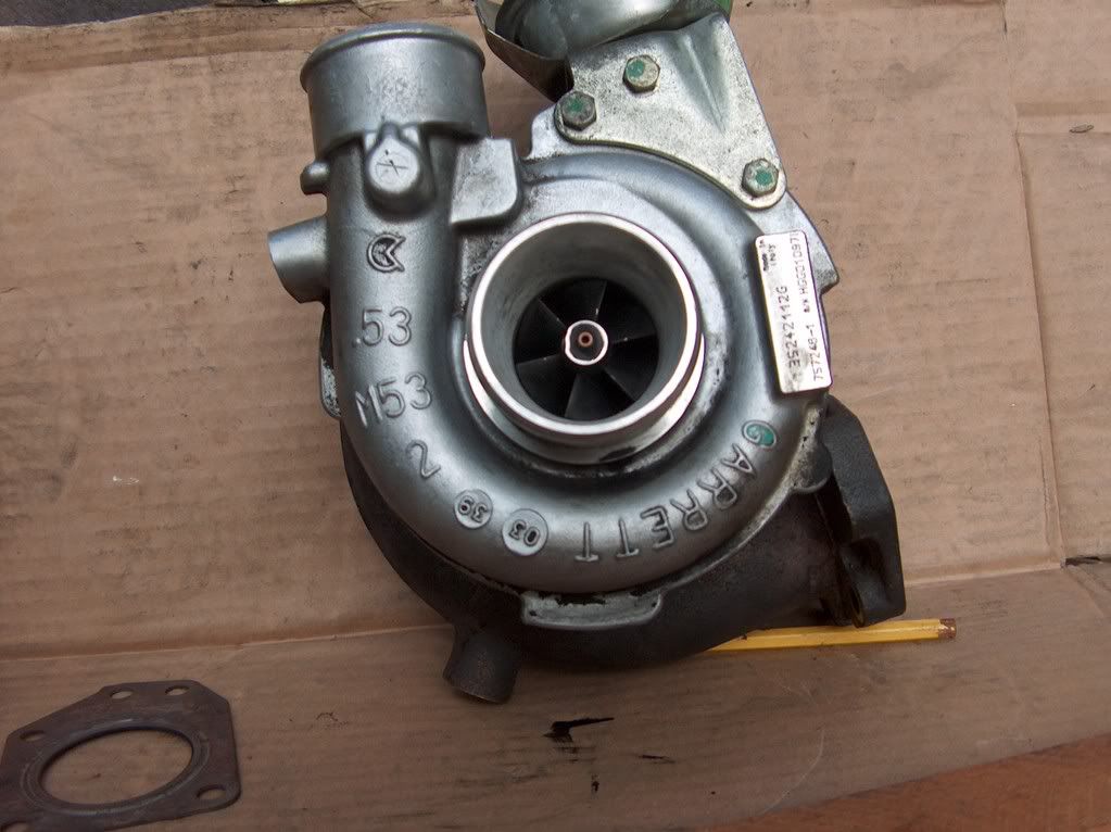

Does your turbo look like this?
http://www.Colorado4Wheel.com
Knowledgeable - But Caustic
PostPosted: Fri Feb 06, 2009 8:15 pm
Posts: 3092
Location: Texas
Should look like this:
http://www.lostjeeps.com/forum/phpBB3/vie ... 072#361072

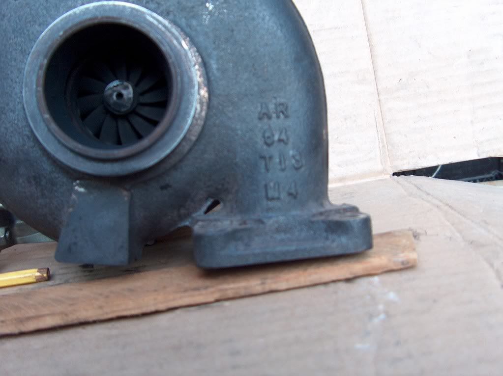

.53 compressor A\R - that's the measurment of the radius from the shaft centerline to the exact center of the nozzle area, in the case of compressor: where velocity becomes pressure
.64 turbine A\R, T13 exhaust flange config (same as for .049 model airplane engines!!) - to get quicker spoolup, reduce the A\R number - to allow more exhaust flow, increase the A\R - the Variable Geometry Technology turbine does just that by altering the turbine snail configuration, moving the nozzle as required to make best use of engine exhaust gas energy output, which is temperature, pressure and volume\velocity - low at low rpm, high at higher rpm and greater loading (towing'n'such)

PostPosted: Fri Feb 06, 2009 11:00 pm
Posts: 6302
No, this is what mine looks like now on the exhaust side:
And the compressor side:
And the oil drain, for the curious:
The results of the autopsy are as follows: Death was caused by catastrophic shaft failure at speed, loss of oil was NOT pumped into the engine or intercooler, but pumped into the exhaust pipe. I strongly suspect that I will have a Batmobile Model 101 Smoke Screen when I finally get it running again.
Now... Can people help me decipher the numbers? I think GMCTD did, but I want to make sure. If I want to match this unit, then I look for a Garrett that has the same numbers on both sides? What about the VNT deal? Does that change anything?
Last but not least: With a failure like this... What could have caused it? Any way to prevent this in the future? Any chance of a rebuild at all?
You guys have been a HUGE help on this so far... Oh, one other thought: If I can somehow connect that banjo bolt to the oil drain (bypassing the non-existant turbo for the time being) could the car move without the assistance of the hairdryer? I REALLY don't have many other options at the moment, and I have classes to get to.
