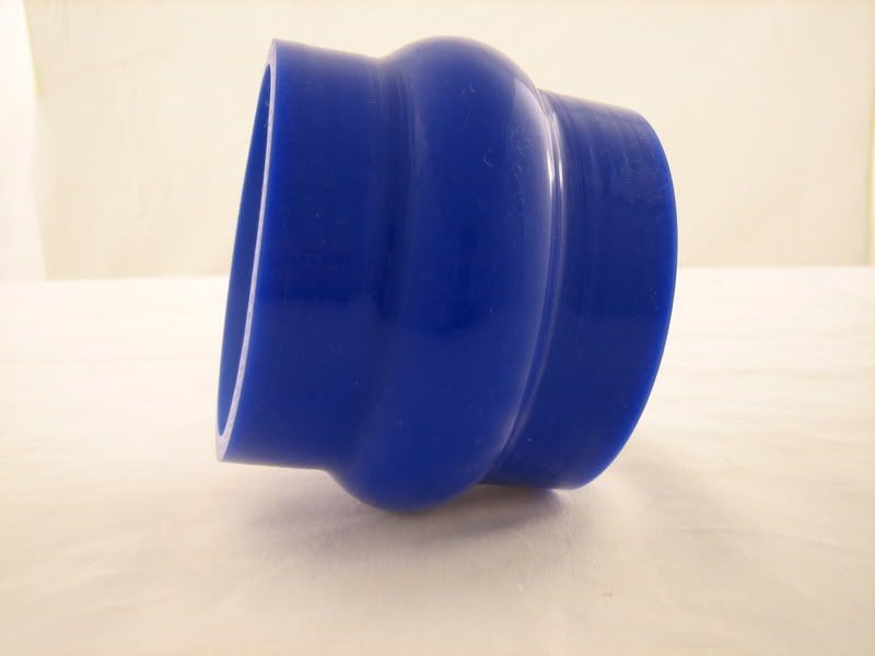

I have the Samco installed and noticed that they expand when revving the engine. You have to be sure they don't touch anything under expansion or you can get a blow out. I also believe that the expanding Samco cause more turbo lag off the line. I have my old hoses and want to work with a local shop in WA to bend stainless steel and get flex connectors for the ends. The advantage would be not to cause more turbo lag and no chance of blow out, the disadvantage would be cost of the flex connectors and clamps. I thought someone was working on this but haven't heard final results yet.

Just make sure your flex is bubbled in the middle. Standard couplers don't do well during engine movement.
Yes sir Rich, that's what make it a flex connector. On the larger diesel diesel I work on in the county garage there are two or three bumps separated with wire on the outside.

Good, I am glad to see someone knows what they are doing. You would be amazed how many people in the automotive world thank that because silicone is flexible, it must be a flex coupler. :roll:
