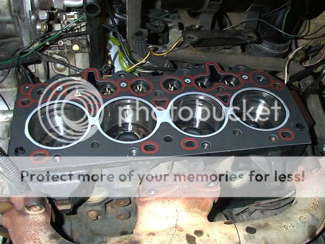

This was after 80 000 kms of a K&N which was regularly cleaned and reoiled using their kit.
This Guy's post and photo speaks for its' self.

I can second the elevated wear on the crd with a k and n, i used a drop in and experienced elevated Aluminum and Iron (several times more than normal) and that was only for 6k miles out of 9 on the oci.
The dirt in my intake wore the piston skirts and liners at the thrust faces, producing aluminum. and iron.

I would like to know what that guy's turbo look liked. That engine should have Sh*ted out 2 turbos or more before that type of wear would have happened....

Now I'm not saying that the K&N's let in more dirt, HOWEVER, again, you are going to blow a turbo up before you get any type of wear like that. It looks like excessive piston slap due to any number of things such as a defective vibration damper, If the engine has a counter weight set up like a deer motor, the weights could be out of phase due to some one not timing them correctly when a timing belt was done, OR I would be it was chipped which was causing an over fueling issue. If you look at the tops of the pistons, you can see that they are eaten away. Now if it is fueling, it is going to cause excessive pressures and temps. Looks like the "marks" in the liners are due to the piston cooling jet not being able to keep the piston cool which cause the piston to expand and deform causing cracks on the face and cause excessive wear on the lines....
